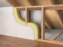

(Architecturally, Knee Walls are primarily a short wall (commonly in an Attic of a structure with a gable room), used to support the Roof Rafters and block the edge spaces that are too small to utilize. For example:
Of course its been a minute since I was studying Architecture, and what I suspect you are talking about is either a partition, or simply the wall below the window you reference(?).) :)

The knee wall is the foundation of the house, it's a basement.
