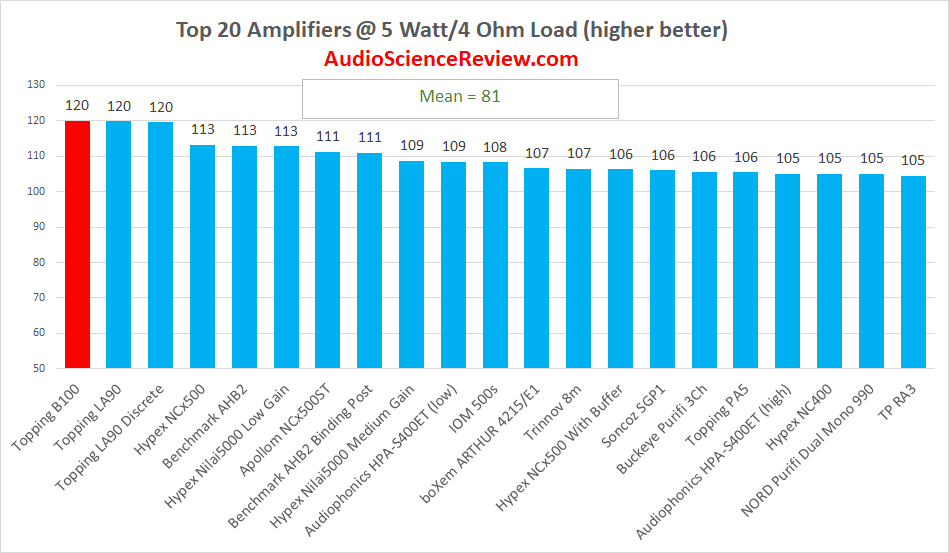

Amir's measured performance of the amp is rather Impressive. Incredible, even. How much negative feedback does it take for class b to actually do that? I wouldn't have thought it possible, but I'm educated in the lowly biological sciences. Where's @PENG ?

By the way, this class B amp has around 100 dB SINAD, ie 0.001% THD+N down to just 20 miliwatt, that pretty much means nothing beats it in crossover distortions including class A amplifiers!!!
