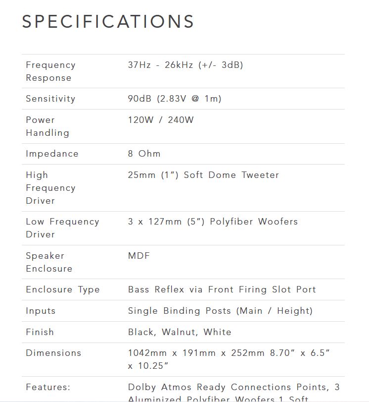

HI Jedi,
Attached Screenshot for you specsheet of Jamo S809
Yes home theater for my Movie room and Music for my hall (incase we have parties)

HI Jedi,
When your 8-ohm speakers are 90dB/2.83V/m, you don’t need much power. So 90W-100W should be good for most cases (typical rooms).
