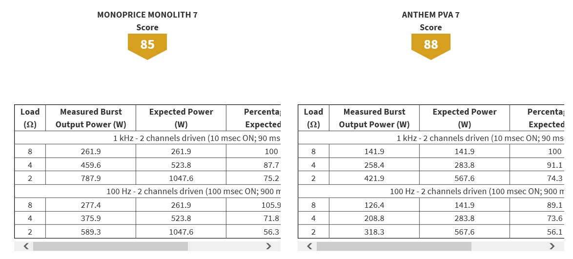

The burst power is an example where there is an interesting metric but rating the Benchmark over the NAD is absurd when the NAD is considerably more powerful.
If 400 watts is required at 4 ohms for a "burst", then the NAD will deliver it and the AHB2 will be 204 watt shy. This is a new definition of expectation bias. :)
Here are the bust mode measurements for the Monolith versus the Anthem:
Once again, the M7 gets a lower score though it significantly bests the PVA7.
Perhaps, it is intended to measure with the expected power supply of the amp but I suspect the audience for this site wont get that distinction.
Theoretically, a 25 watt amp could be measured that scores perfect 100 if it can double down to 2 ohms with the correct power limiters in place.
- Rich
Seems to me the whole thing is clear as mud..:D Hopefully Gene will figure out what's going on by getting some answers from the authorities.

NAD confirmed to me that the THX Frequency response graphs aren't correct and they also were puzzled by the power burst test results. This is getting interesting.
