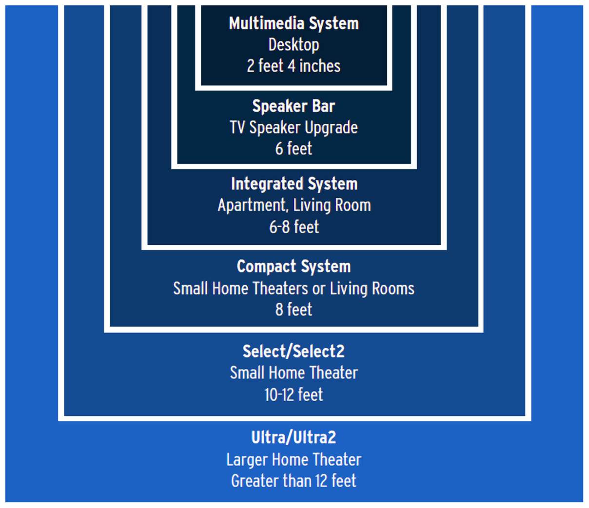

The article you've linked to is same as I did earlier, but you've known it if you'd bothered to read it.
The real issue is the basic definition of what is THX reference volume - it may not be 105db on every various THX cert level as you might think. I've tried hard, but could not find exact criteria for most of certification with sufficient level of detail. (Believe me I tried and I'm usually pretty good about this stuff)
Second issue is what is "entire frequency range" - This for example doesn't mean 20hz-20khz, in fact several certification, like Multimedia and Integrated ask for mere humble 35hz number
Bottom line you could see in this graph how many various THX certs levels are just for home:
From here:
https://davidsusilouncensored.wordpress.com/2014/01/20/all-you-need-to-know-about-thx/
I guarantee you - they all have different requirements in order to certify. I am asking you here two things:
a) Did you honestly had previously hear about all of these and
b) Is it entirely honest just to slap label "THX" on all/any of these audio products and expect same the level of performance?
Do open noaudiophile review I've linked to before. See the product image - Do you see how it says "THX Multimedia" on top? I don't. It is simply says THX and here lies the problem.
And then there are THX Certified doors....
https://www.technobuffalo.com/2010/01/12/does-thx-certification-matter/

Either way, yes there are different levels of THX certification, but if one understands those levels they can be certain they're getting that performance. THX reference levels for cinema is 105dB peak, calibrated with -20dBfs pink noise to 85dB for all speakers (or 75dB at -30dBfs). Digitally speaking, nothing can exceed 0dBfs, therefore no single channel will exceed 105dB (115dB for the sub) at 0dB on the volume knob. If dolby digital is used, dial norm will attentuate all sound so that the average dialogue level is -27dBfs, as for how much dynamic range the engineer decides to use, that's up to them. DTS is generally mixed 4dB louder, but either way, the dialogue is still an average of -23dBfs
The point I'm trying to make is that THX is a standard. For example, Ultra 2 and Select 2 receivers must all operate at a minimum level based on the specifications of those levels. If it can't then it doesn't get the badge.
So many stickers and badges mean nothing, for example, onkyos "massive high current power supply". There is no standard or specifications on this, and I can promise you many of onkyos low end receivers with a "massive H.C.P.S." would crap out under high current demand like any other cheap power supply. Ultra 2 receivers and Select 2 receivers must be capable of swinging a specific amount of current per channel in order to get the badge. Have you ever seen an ultra 2 or select 2 receiver with a lousy power supply? I haven't. If a receiver has a THX Ultra 2 certification, you can expect it to deliver based on the ultra 2 specifications.
Lastly, the reference level can be found on THXs blog http://www.thx.com/blog/questions/what-is-the-reference-level/
Each THX specification has a reference level requirement based on a specific room size. If used within the limits of the specifications, you can expect reference level playback without distortion.

THX has simplified their home theater performance classes at least. Go to this page, scroll down a bit. Now we just have Compact, Select, Ultra, and Dominus. For speakers, the higher tiers of THX are still meaningful and not easy performance standards to meet. But you are right on an earlier point, that by having too many certification types and levels, they destroyed their brand by diluting it.
Yes, but it's not always obvious what level of THX certification product has received. As I said - just looking at the product one would often see only a single word - THX. But yes, if product is certified you could expect to perform according to it's THX cert level, but what this level means exactly? Room size differences between make not enough sense in combination with exactly same "reference level" requirement.
Source please and can you 100% sure that this applies to all various THX levels? Any minimum required THD levels?
Yes, THX is standard or more specifically a big pool of standards and it's not always clear which exactly level the product is certified of.
Agreed in general, but Again this is where it gets confusing - for example THX Ultra2 no longer offered, instead there are 4 various levels of THX for AV receivers:
http://www.thx.com/certification/thx-certified-av-receivers/
Including "THX Compact" - I guarantee you products with this one will no out of their way to display correct cert level.
That one is pretty vague, marketing bs and meaningless. What you said earlier actually made sense, but since I can't find it anywhere, no longer sure it's really applies, especially on various levels.
Besides vagues suggestions of room size and viewing distance for various THX levels, nothing else says anything what are these mysterious "limits of the specifications" are.
Well, you're right, but these levels only apply for "loudspeakers"
Scroll down a bit on this page till you get to "Our Programs" list
You'll see a separate "programs" for Speaker Bars, Integrated Systems (ie HTIB) and multimedia systems among other more usual suspects
My fav: http://www.thx.com/certification/thx-certified-interconnect-cables/
It's about as useful as barn door in the middle of amazon jungle.
