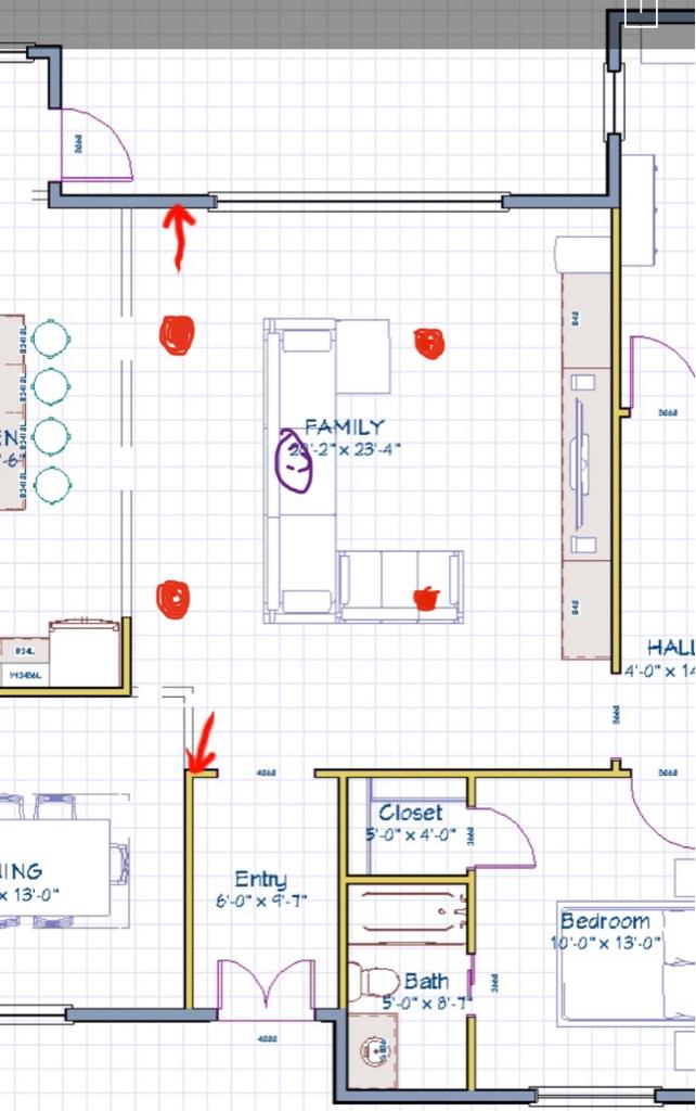

I am putting home theater equipment in a family room, not in a dedicated room. Room is 20' deep x 23' wide but the 20' is artificial because the rear of the room is open to the kitchen. Ceilings are planned to be 12' high. It may drop to 9' at the kitchen. We're unsure (in design phase).
Here is my current speaker selection for 5.1.4. It's ~$4000 budget for the speakers. I plan to drive it with a Denon AVR-3700H or 4700H.

I realize that I have a non-ideal room. Here are my constraints and concerns:
The fronts are limited to about 7.5 foot on center so I need something with a good dispersion pattern to compensate. That concern definitely drove my selection of this center speaker also. Primary viewers will typically be 2 people sitting near on-center but I don't want it to be hideous sounding with guests.
The surrounds must be in-wall and discrete. I have no flexibility on this. I'm thinking that the bipolar surrounds will help with the non-ideal placement. Am I right or wrong?
What do you all think? Am I making any bad decisions? Should I consider any other brands? I'd love to get the budget down to $3000 but don't want to make bad compromises. My choice of surround speakers seems very expensive for example but I don't want to get it wrong.

Nice drawing. If this was my space this is what I would do:
1. Go with the Monoprice Monolith THX-460T towers instead of the THX-365T for left and right. Or another favorite pair of towers for stereo. I have the THX-365C and it's a really powerful center but not much bass. I don't think I would be satisfied with the THX-365T for this size room as left and right?
2. I would go with two HSU VTF-3 MK5 HP Subs at $1730 delivered instead of the $1447 Monolith sub with tax. The HSU subs are 30 lbs lighter and have a beautiful finish. This dual sub setup would provide powerful sub options.
3. If I wanted to save money, I would go with the Denon 4500 refurb from accessories for less for $999 shipped. https://www.accessories4less.com/make-a-store/item/denavrx4500h/denon-avr-x4500h-9.2-ch-x-125-watts-a/v-receiver-w/heos/1.html - Denon refurb's each unit. Mine looks like brand new and it works great. The 3 year warranty offered is just as good as new. Best value in my system.
I have not used the Atmos or surround speakers you quote so I'm not able to offer input on them but they sound interesting. Have fun!

Jeff, are the red arrows to indicate the in wall surround placement? If so, and you can actually install them, then I’d say go ahead with Atmos. 5.1.4. I would choose monopoles. Especially since they’ll be at some distance, and the spec from Dolby recommends monopoles. Bipoles can work if the viewers will be very close to the speaker but imo you’ll be fine. Also, I just dislike bipoles ...
If can swing two subs. I would also recommend that as well. That’s a good amount of airspace and a pair of the aforementioned HSU’s, or monoliths would be great.
Also, what is the ceiling height?

Yes, the red arrows are surround locations. I can get them near ear level at those locations. Should they be a bit above ear level at that distance away?
I appreciate the advice on using monopoles vs bipoles. I don't have any experience with those so I'll focus on monopoles.
Given the placement, do you think they have to be aimable? Any recommendations on the surround speakers?
Personally I’ve found no benefit to aimable tweeters. In fact, my belief is that when you point the tweeter in any direction that is not straight, it can create diffraction issues from sounds interacting with the baffle.(think of how your voice changes when you put your hand next to your mouth and then speak).
I think close to ear level would be great. Since they’ll be behind the couch by about 4’ you said, all listeners should have a good line of sight(to the ears) to the speaker. In situations where the surrounds are to the sides, higher placement can help with getting over listeners heads.
Iirc you are using rsl c34e’s for Atmos. Good choice. For surrounds, ilI usually prefer to match the line of the mains by manufacturer if you can. However, when I replaced my On wall surrounds and went IW, I used these JBLs(my other speakers are JBL too but these were a great choice to fit in my column as many were too wide).

So, I don't get any credit for suggesting the surround placement?:rolleyes: No worries. Getting a look at WL's arm is reward enough.;) I think monopoles at that location are fine and aiming them toward the listener would actually create localization. Isn't that why bipoles were recommended at the sides by THX once upon a time, to create a null? The monopoles are far back enough and will be fine. Their location will help fill the kitchen and dining areas with background music during gatherings and such. Denon's all channel stereo mode is very good. No, they are not all equal. Onkyo's sucks. Anyway, I think your proposed system is coming along nicely and you will be very impressed with it.
Well, if you like my ARM....lol
I will definitely give you credit for surround placement. I wasn’t sure where it came from but I was hoping those locations could be possible.
