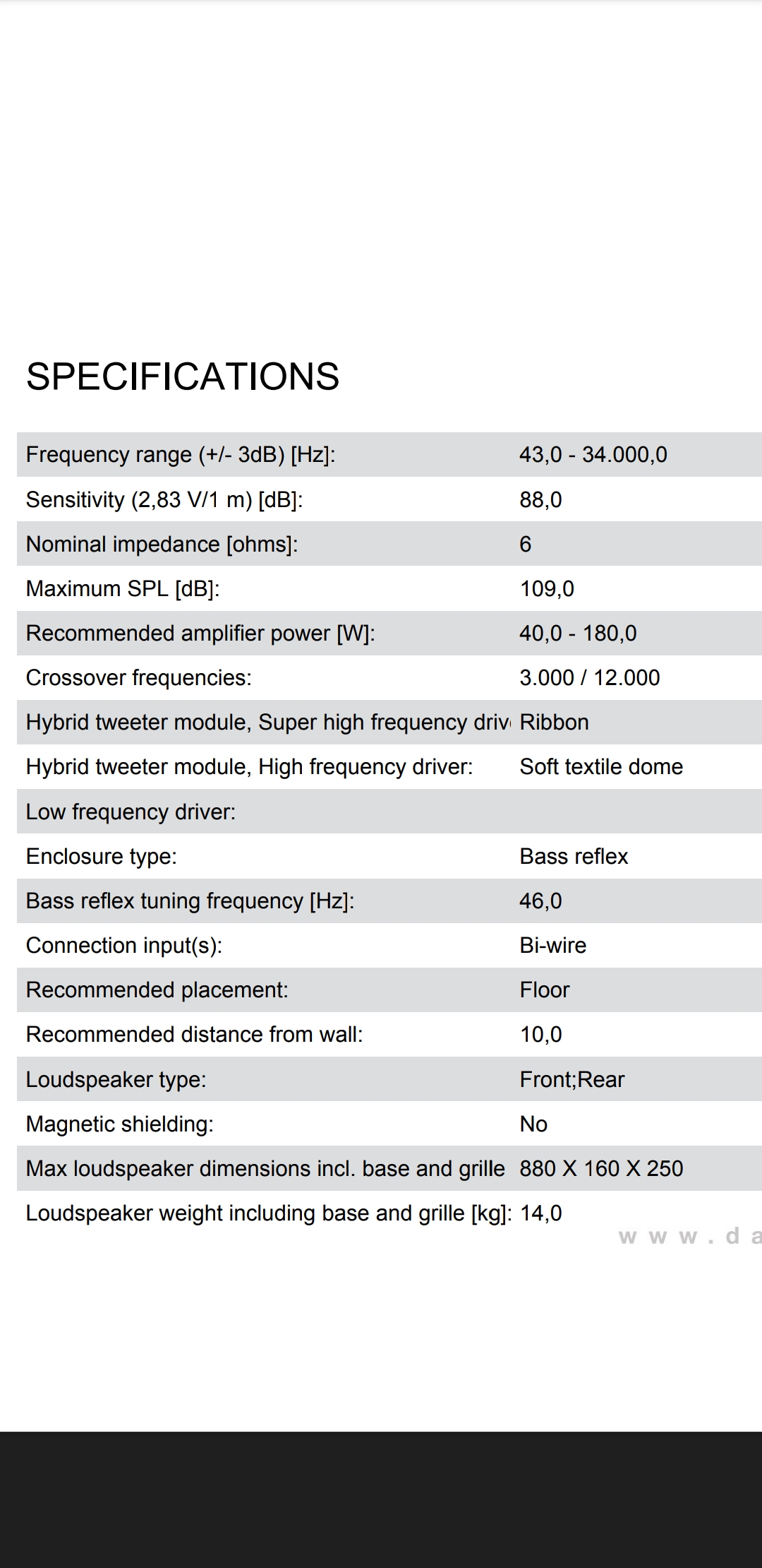

Here are the speakers i want to drive.

I like how under the 'Loudspeaker type" spec it lists "Front;Rear." I really hate it when I get a speaker and it just has a front but not a rear.
I noticed that too, which is why I feel information is being withheld. I suspect we a dealing with a disaster of a speaker here.
I would have guessed its a bipole design from that weird "Front:rear" type spec, but the hybrid tweeter spec means it's almost certainly a speaker from Dali.

I am going to make a few assumptions here and based on the info provided by you:
Speaker sensitivity: 88 dB SPL
Distance: 10ft
Number of speakers: 2
Near Wall: yes
To get THX Reference levels (85dbl + 20 peaks), you'd need an amp capable of delivering a whopping 120Wpc into 6 ohms. This is solid mid-range AVR territory.

I just did that based on your speaker's specs that says maximum SPL is 109 dB so based on no room gain, there is a loss of 9.7 dB at 10 ft that is approx. 3.05 meters.
So in order for the speaker to never sound really bad, you can push it to output about 99 dB that is 6 dB below reference but is still very loud, much too loud for me anyway but ymmv.
That means you need about 156 W to drive one of those speakers to produce its rated SPL at 10 ft (3.05 meters)
