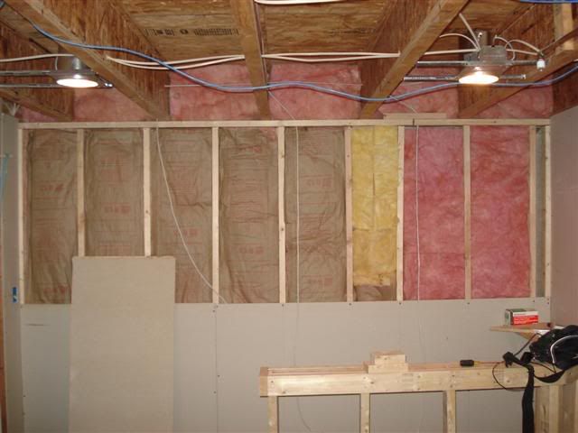

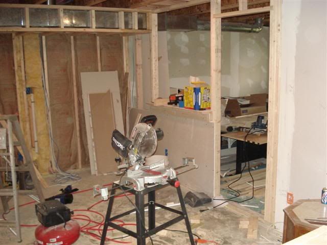

Here are the pictures finally:

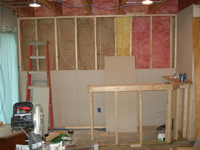

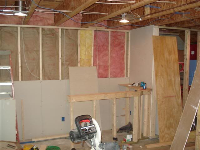

The back wall where the rear surrounds are going…you can see the speaker wire hanging down. I pulled wires for 6.1 and 7.1, just incase I don’t have my two rear surrounds by the time this is finished

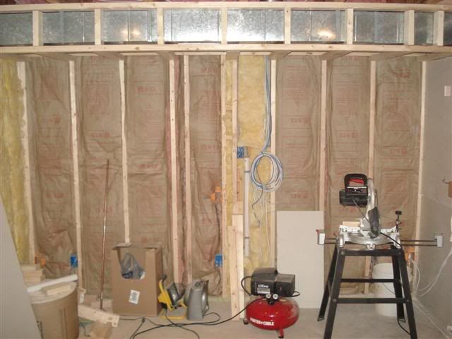

The front right of the wall where T.V. is going
Front wall center

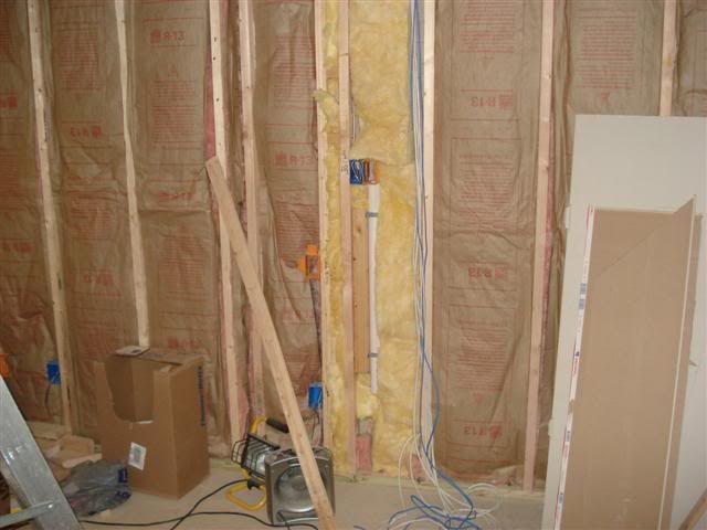

Rear right wall
Another picture of back wall

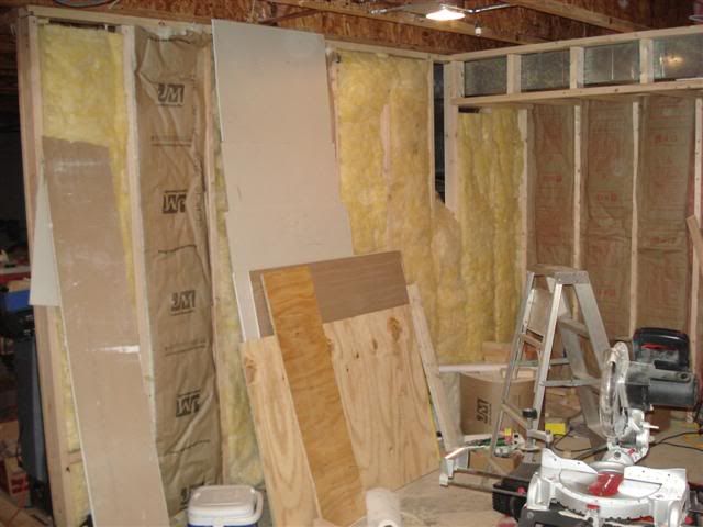

Left side of front wall….the reason there is insulation is cuz the furnace is on the other side, and “trying” keep the sound down a lil

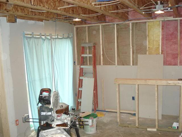

Right side of front wall…..there was a wall there, but decided it would be to “closed” if I didn’t open it up….to turned into a lil countertop. When I have poker games in the other room, everyone and talk without walking up to the “door”. I have it roughed in for a door, so when the time comes to sell I can throw up some studs, doors, and make it an extra bedroom
Another straight on of rear wall
Rear again
Front wall again
Alex2507
Alex2507
I just want to mention that the faced insulation that you are using is not as effective at sound attenuation as plain/unfaced insulation. I don't know how much the effectiveness is compromised but it's a no-no. Adding an extra layer of 5/8 drywall would be a great help in reducing sound from the furnace.

I agree with Alex, though regarding the insulation. Looks like its coming together. Just keep plugging away. Very interested in seeing finished theater.
E
eurovw89
The front and rear wall are exterior walls which needs faced....the insulation is left over from a lil while ago and thought I was used it. Why is it a big no no? R-13 faced and unfaced are the same thickness, same everything, so why would it be less effective then unfaced?

Alex2507
Alex2507
The paper transmits sound. If you have unfaced insulation on an exterior wall you need a vapor barrier on it. (plastic/polyurethane/visqueen or whatever they call it in your part of the country.)
E
eurovw89
This is a townhouse....so part of the wall is exterior, and part is a joining with neighbors basement...so half of the front and rear walls are joining with the neighbors
