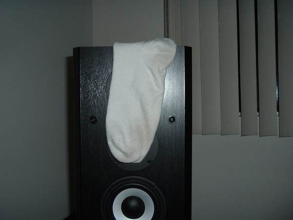

I've had pretty good success with the m80s by draping socks over the tweeters like so:
Now that is comedy :D

The fact that you have resorted to stuffing socks in the bass ports and over the tweeter proves the M80 is wayyyyyyyyyy to much speaker for your situtation.
