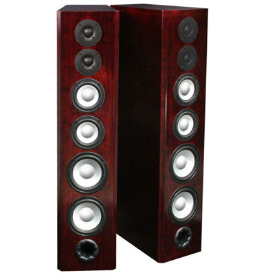

General info:
Height 39.5"
Crossovers at 220Hz and 1.8kHz.
Photo of speaker:
