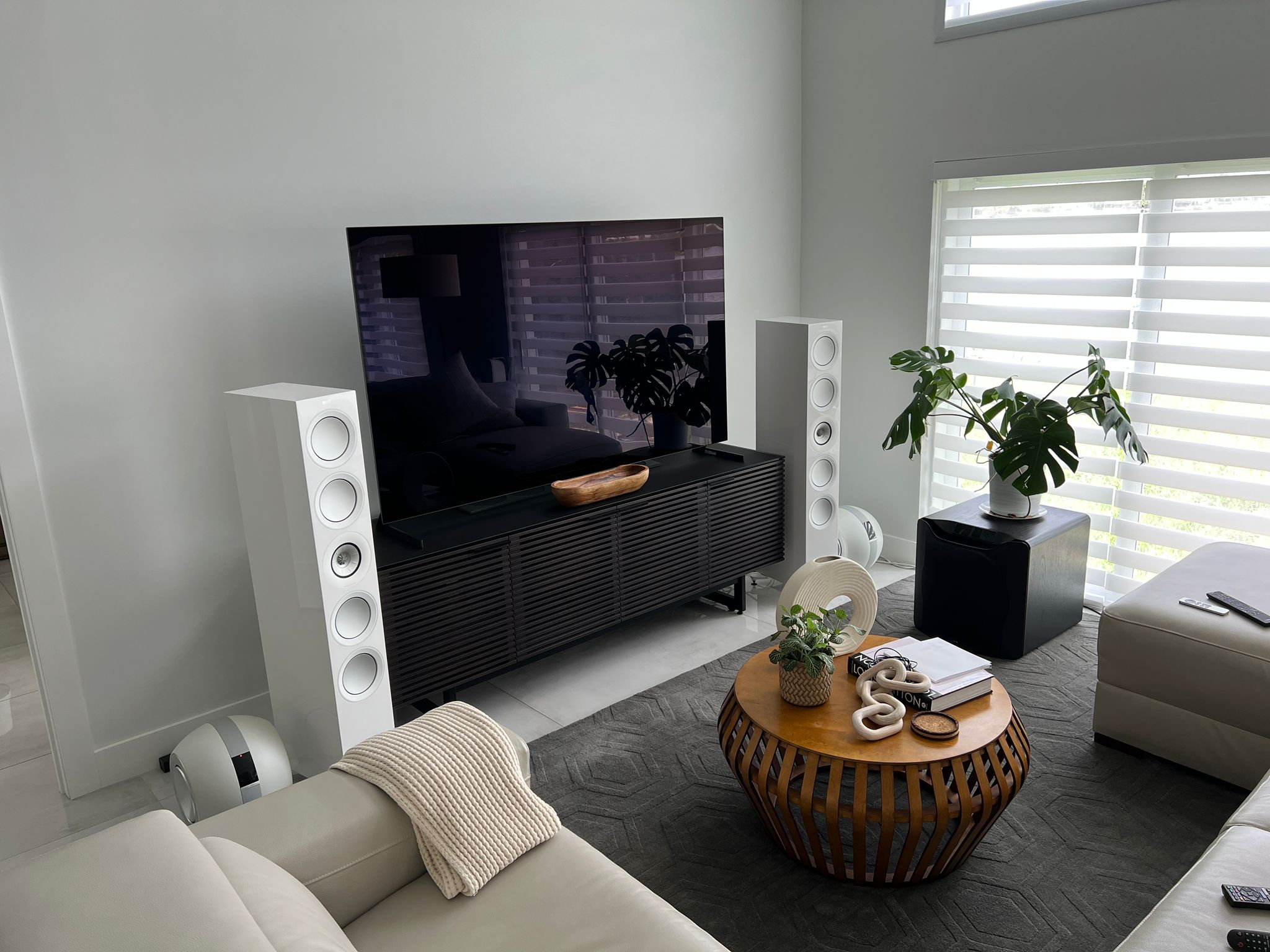

Believe it or not, my wife really likes the look of the PV1Ds. It was a challenge getting my her to approve a 5.2.4 system in our open area living room and below is what I was able to get "approved" lol.
I am hoping to hide the sb16 under the coffee table or where the plant near the window is.

I got worried the deal wouldn't last and decided to buy now and think later. For now, I kept the PV1Ds running at the speaker input level and the SB16 connected to the sub line level.
I have the L/R set to small with the crossover at 40hz (this way the PV1Ds get almost all the lower frequency range that they can actually reproduce). I did about 1 hour of listening yesterday and so far it sounded really good for music - the SVS barely plays anything until I reach a bass heavy track. But for movies it was a revelation! I finished re-watching 13 hours and all the battle scenes were freaking awesome!
I know the way I have the subs setup now is kinda of weird but it actually sounds really good and without doing any calibration yet so we'll see if I even need to get the minidsp.
I told my wife it doesn't look that bad. what do y'all think??

I'm a bit confused. You say you're running the high/speaker level inputs for the PV1Ds, yet you indicate you're running them as "small" and with a xover of 40hz. Generally you run speakers set to large if running high level inputs and just use the low pass filter on the sub for limiting the sub. Can you clarify? Running small and with a crossover using the low level inputs on the SVS makes sense, tho.
Looks fine except for the white speakers/subs/floor :) (Not a fan of that cold kind of look).
The B&Ws subs are connected to high/speaker level and the low pass ion the subs are set to 60hz internally.
I may be doing it all wrong but my thought process for setting the L/R channels to small/40hz is so that the SVS can pick up any lower frequencies directed to those channels during movies or even when listening to music that has really deep bass.
