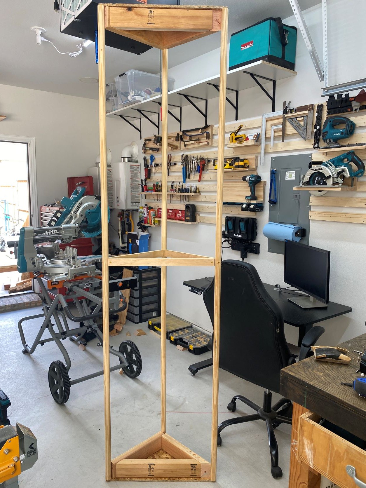

Here is a link to the product from Home Depot/Lowes. And some pictures of my bass trap design using dowels. Im thinking the rounded edges will make the corner traps look cleaner when wrapped with fabric.
Look at the second page of your link- it shows 'Acoustical Performance' and below that header, it shows thicknesses and the NRC at various frequencies. At 125Hz, the NRC is only .33, so you'll need at least three layers of 2.5", but if you look, the absorption doesn't necessarily double when the thickness is doubled, so you'll need to work with it to get the results you want and that can only happen after you do some testing, to find the problem frequencies.
