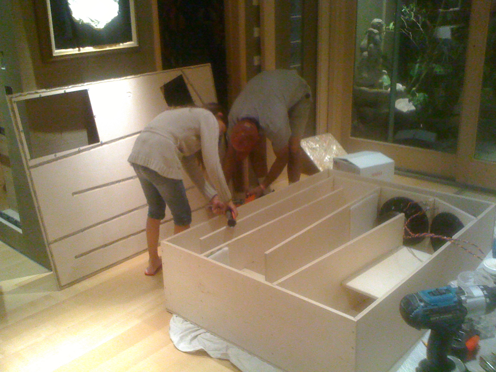

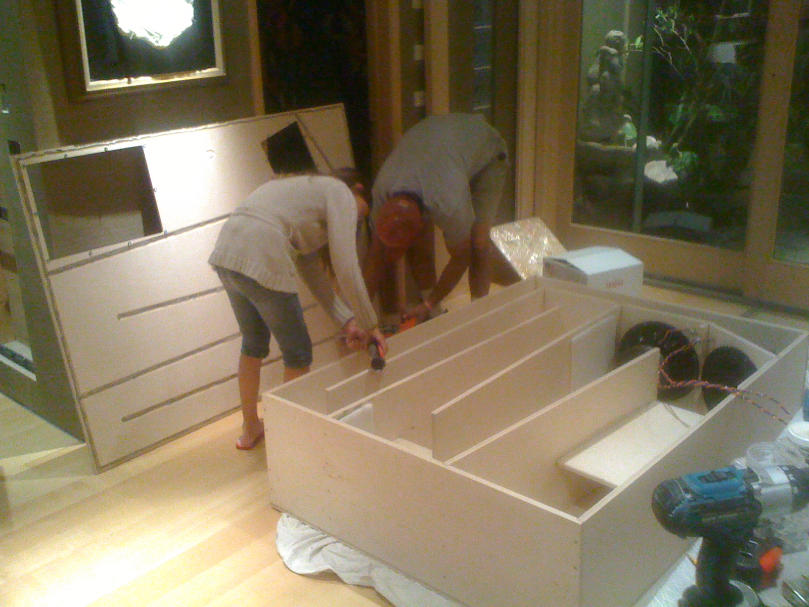

I just looked up the DTS10. Wow. I've never seen one of those before. They look all transmission line-ish. There are two 12's in there, right? Looks pretty cool.
The overall layout is different than the lines I’ve been studying or am familiar with... especially the placement of the drivers and the opening so near at the large end of that labyrinth. I’m suspecting it is more of a horn loading concept. It definitely looks like they are still funneling the energy from the back of those drivers all the way through the box in a way that will hopefully bring it in phase with the sound waves from the front of the drivers...

Oh yeah! I recognize that now. It’s a tapped horn if I recall correctly. I think I stumbled on some DIY plans for something like that.

Now I've had a chance to dig deeper, it is indeed the Danley Sound Labs Subwoofer:

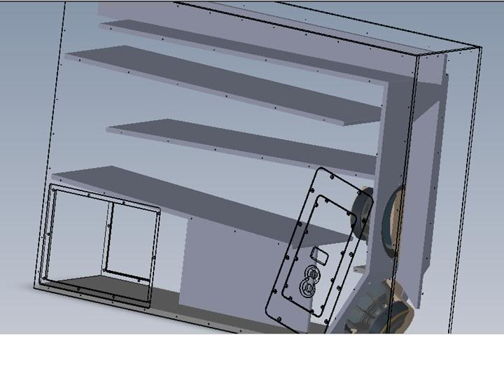

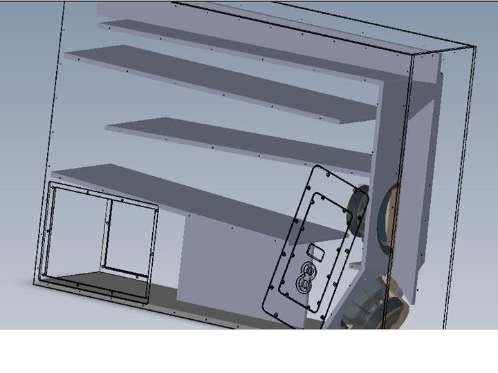

It was hard to see in the photo above, but they have the drivers in an opposed configuration. Curious about the phase, still. This CAD drawing I found on Audio Karma from 2010 shows whats going on in the business end a little better. :)
