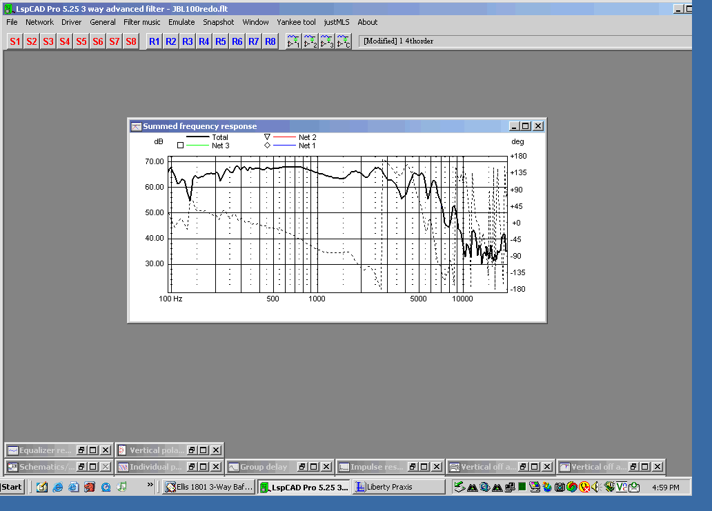

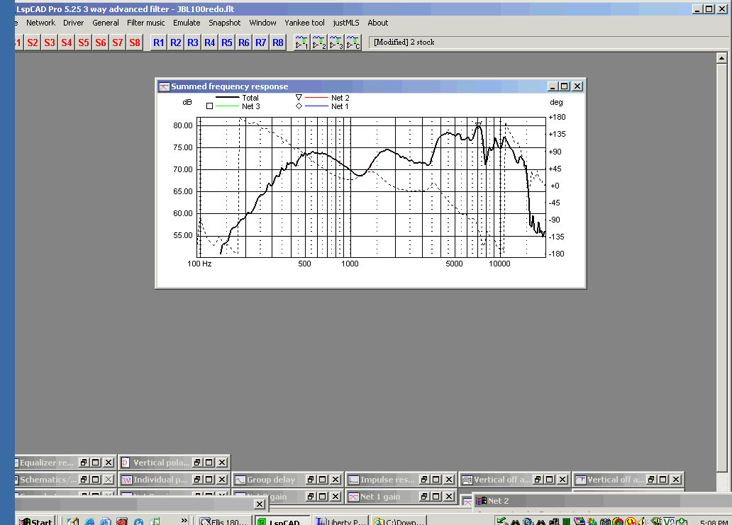

Thanks for that link. The Peerless should make a good midrange between 200 and 2000 Hz, but do not cross it over at 950 and 5000 Hz!
Compare it to the unfiltered freq response of the JBL LE5-2 midrange. Smooth is not a word I would use for that. Because the JBL 12" woofer was capable of smooth response (at least on axis) in that frequency range, a crossover at ~950 was a way to eliminate part of the midrange's roller-coaster frequency response. It also distorted a lot more when you got well below 1 kHz.
