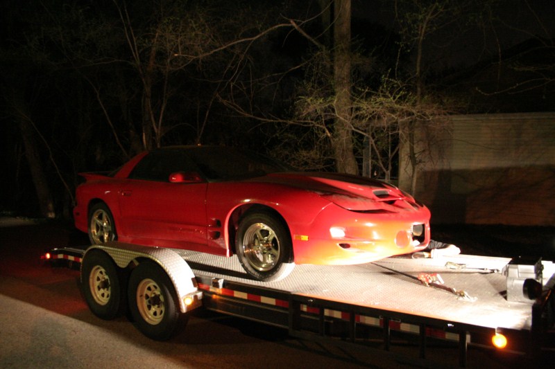

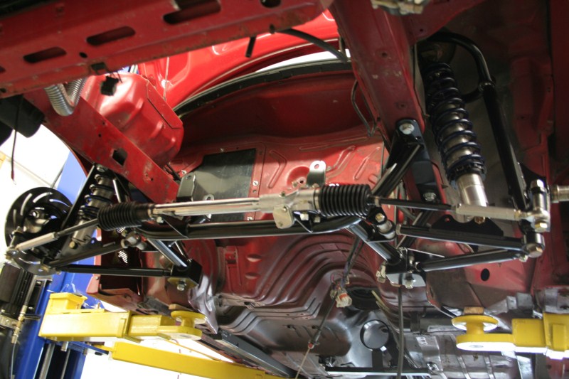

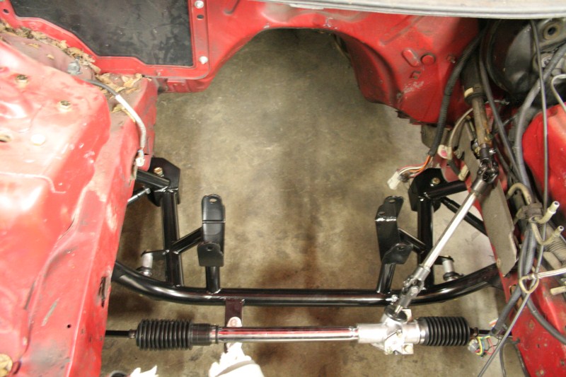

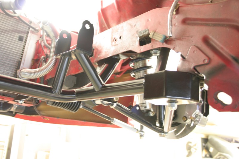

Well after a LONG wait it has been released from the chassis shop. While it was there it got a cage, adjustable seat mount, harness mounts, front and rear Strange drag brakes, K-Member, Upper and lower A-Arms, spindles, manual steering rack, solid motor mounts, manual brake master cylinder and adapter bracket, aluminum TH400 trans cross member, changed out the rear lower control arms and panhard bar (only non-Midwest Chassis pieces that were left on the car). There is more that I am forgetting, but thats about it. All of the suspension pieces and the cage are all chromolly and light as hell. We took well over 100 lbs off the nose of the car with this suspension. Enough talk, on to the pics!!!

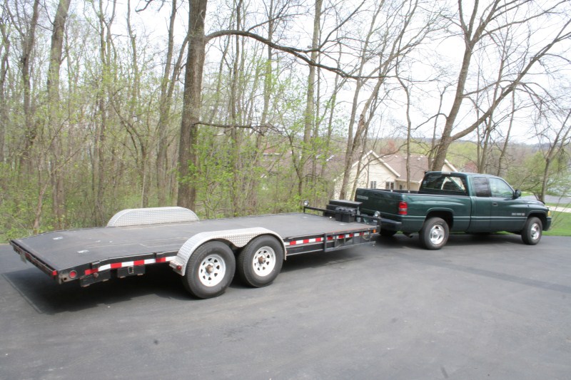

Trailer all hooked up and ready to go

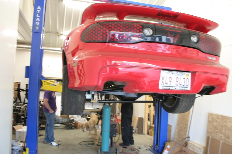

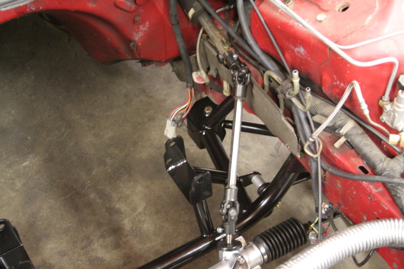

The car was still up on the lift when we got there (gave me a chance to get better pics)

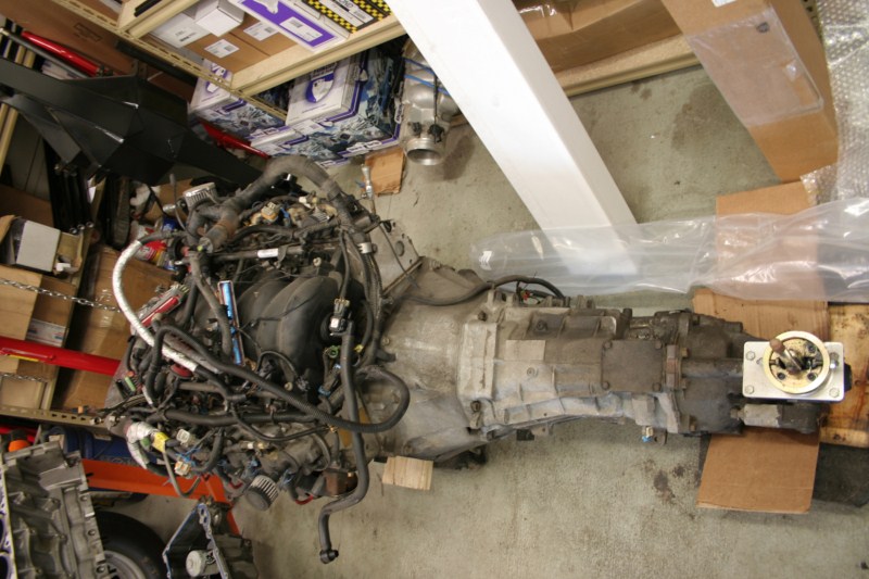

Old motor and trans (Stock LS1 and T-56)

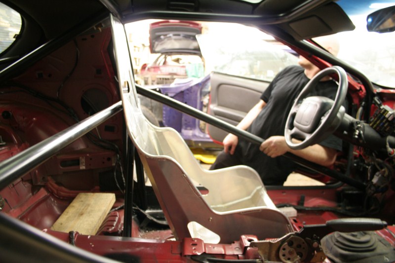

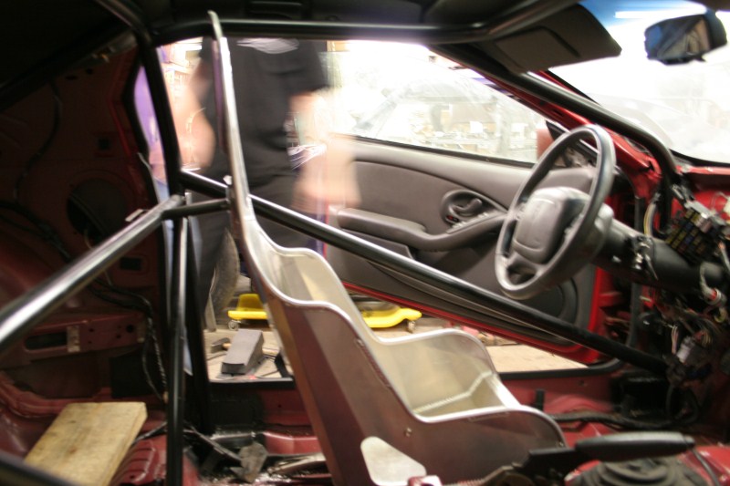

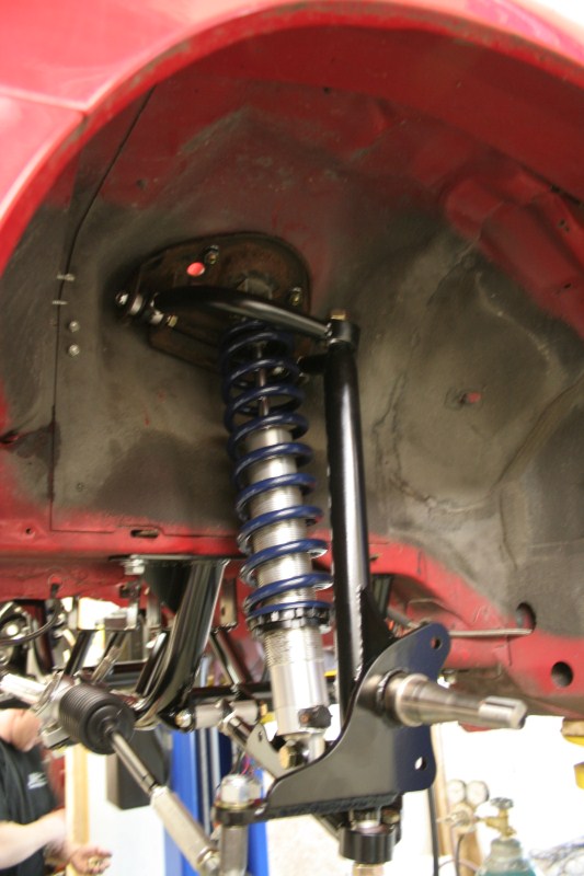

Our first look at finished product!

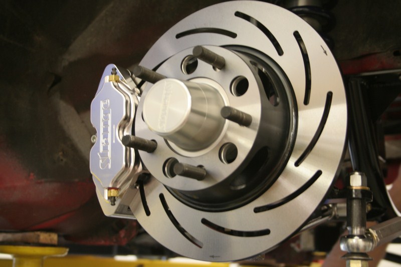

Without the brakes
With brakes
From the back side. The second set of holes behind the lower shock mount are for travel limiters.

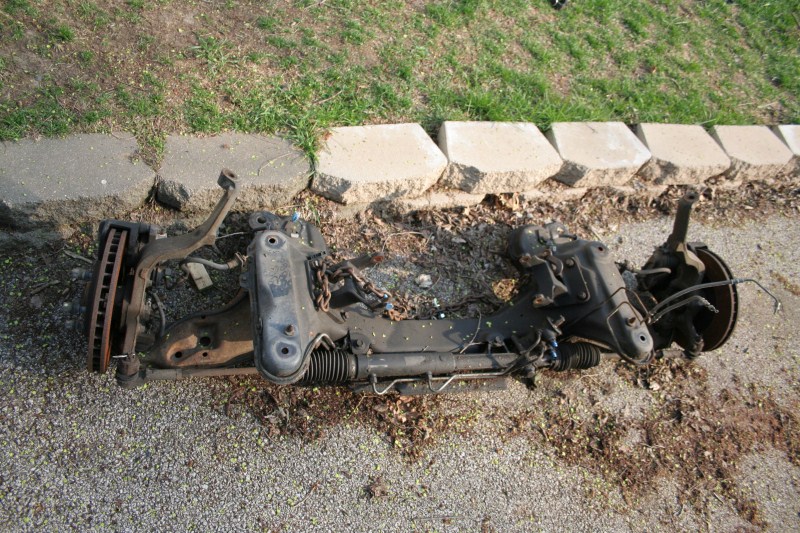

Stock **** (if you cant tell, its heavy!!)

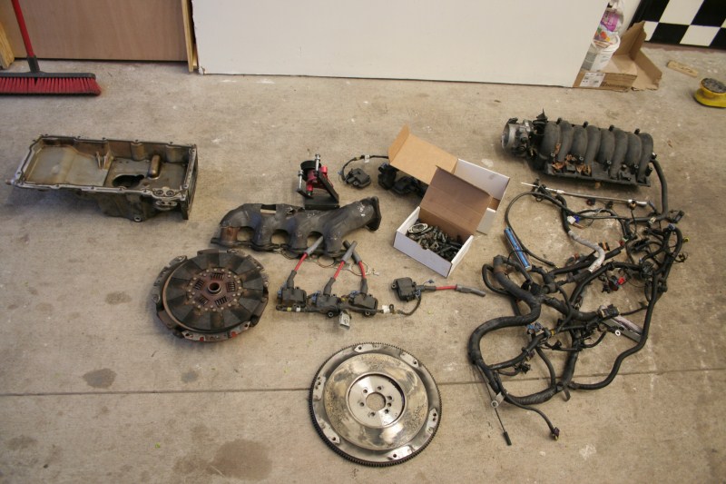

We ended up selling the motor to someone who works down there, here is the pile of parts we took off.
