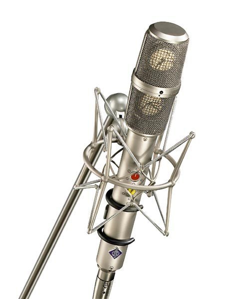

In my recordings I used either crossed figure if eight (classic Blumlein) or most often as these tapes were broadcast the M-S technique.
Shown above is a cardiod mic above a figure of 8 large capsule mic. My large dual capsule mic allowed the use of two identical capsules one above the other and allowed for the top capsule to be set to an omnidirectional pattern for maximal ambiance capture.
However the effect on playback was virtually identical and both techniques are classic intensity stereo.
