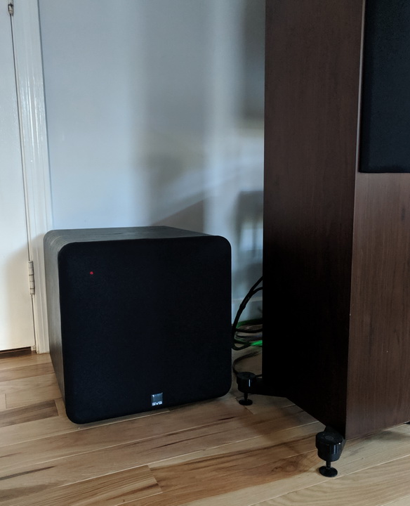

Not everyone likes the aforementioned grill on the SVS SB2000, PB2000, and other up-market subs. I don't mind it and do appreciate how tough it is, but I have only two places in my room for a sub and the better one puts that grill on my SB2000 touching the left rear plinth of my left KEF R500 speaker.

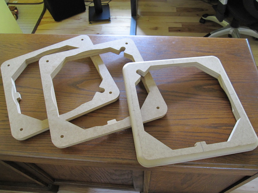

After a few months of haranguing him, he relented and did send a drawing of the grill to a forum member in California, along with two sets of attachment pins and pressure-adhesive logo plates. I had started the thread saying I'd make some if I had the info, so that member did contact me. I got the drawing and hardware, and got to work. My son prepared stock by laminating to sheets of 1/2" MDF to make up the 1" thickness we couldn't buy locally.

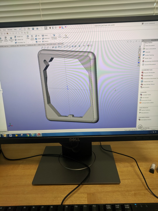

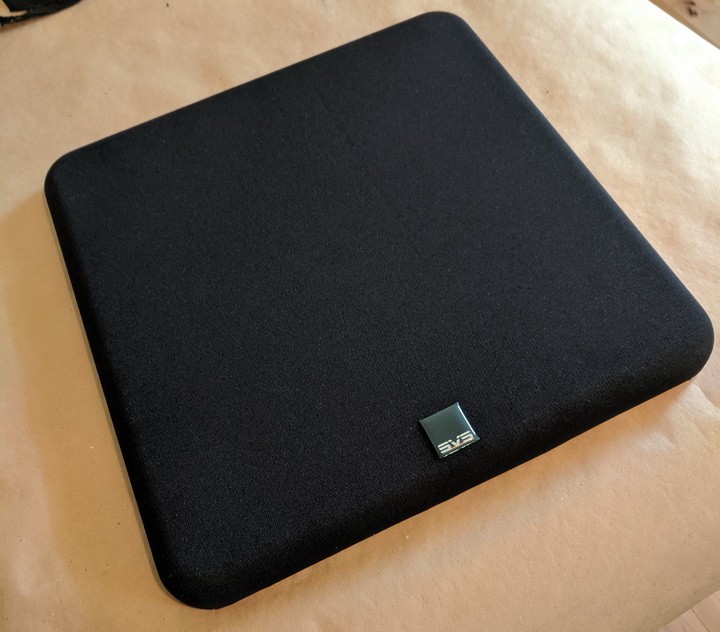

I started by turning the 2-D drawing into a 3-D model on Solidworks CAD system at work. With the permission of my direct supervisor and his boss, I was able to use a CNC metalworking machine, a 1/4" carbide router bit, and a 5/8" corner-rounding cutter to make a couple. Every dimension is within 0.1mm of the print. Friday afternoon I clocked out early and got started, Saturday morning I went back and finished cutting. When I got home around 1pm, I painted them. Just today I put the finishing touches on by covering with fabric from SimplySpeakers.com and pounded in the barbed metal posts supplied by SVS. Here's the result of my efforts.

Couldn’t just move the sub an inch over?
Nice work though!
Nice work though!
Not really. There's an active door right there and placement of the sub limits how much it can open. Anything less than 90 degrees and stupid people will hit the sub with the door. That's another issue with the metal one, it's quite unforgiving if someone was to actually hit it hard with the door.

The steel one is "ok" with me as I've lived with it for almost 4 years now. Compared with the one I made though, it's a night & day improvement in the looks in my room, with my speakers and other décor.

i know it was a long time ago, but i wanted to make on myself as well. Do you know how i could make the pins, what size are they ?
Sorry, I got nothing. I was a LONG time ago. Your best bet is contact SVS because they may now have a grille for you, or at least the hardware.
