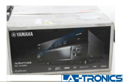

Ok then please give me ur opinion on what receiver would you recommend. My husband likes to feel like he at the concert lol. Good clean sound.
Grab the Yamaha RX-A1080 before the stock runs out. New units are still available on eBay, giving you the link to the top-rated seller:
