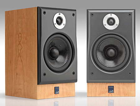

It is not just big speakers either. Here is a really good book shelf I have heard and measures very well.

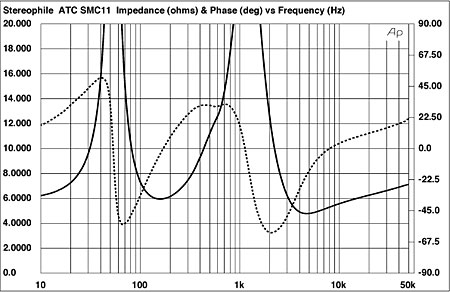

Now look at the impedance and phase curve.
The impedance curve looks pretty benign. Over 6 ohms except for a small region were there is little power demand between 4 and 10 kHz.
Now this is the hard part for members to understand. Look at the phase angles. Its 56 degrees negative at 100 Hz and over 60 degrees negative at 2 kHz.
Now what this causes is not a huge demand for true (actual) power, but a big increase of apparent power over true power in those regions of highly negative phase angles. The problem is that the current has to be provided to meet those apparent power demands. If they can't be met the amp will clip and may be self destruct.
So those little speakers require a much bigger amp than you would think at first glance. You could not drive them with your receiver.
