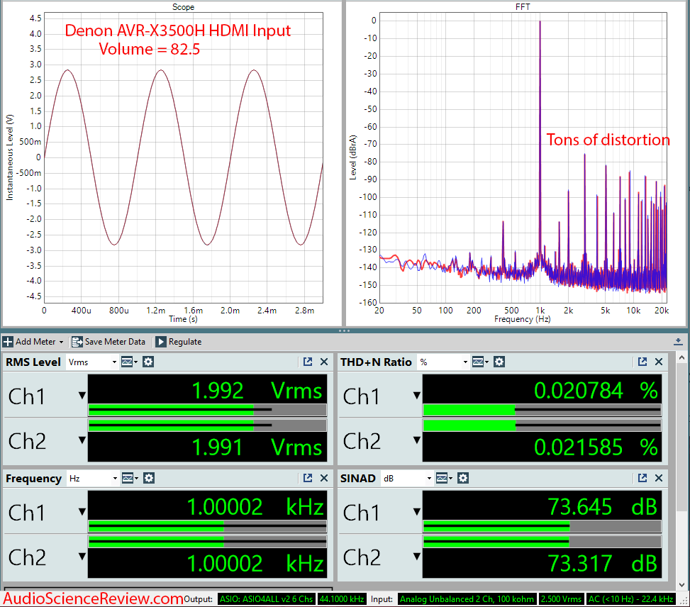

Agreed completely with everything else you mentioned except the SINAD thing. Unless I missed your point, SINAD may confuse people but is not really BS if you consider the fact that most DACs manufacturers now seem to have standardized on specifying THD+N in dB (that is, SINAD) instead of % that they used in the old days.
For example, taken from the data sheet of the AK4458, the DAC chip in the AVR-X3500H:
If you do a conversion from dB to %, the AK4458's THD+N would be 0.0004467 and we are happier..
AKM actually used the term/acronym "SINAD" in the datsheet of their older chips, they switched to THD+N probably because they realize fewer people know what the heck SINAD is.
If I remember right someone did say something to me about the use of SINAD and his response is, he always provide both anyway so for those who prefer "%", just ignore the "dB".
I assume he may not realize that the two figures, one right on top of the other, could still confuse people because people are much more used to seeing THD+N in % and now when they see both listed they would think those were two different specs. Also, while most people know 1 kg is 2.205 lbs but much most people don't know -107 dB is 0.0004467%
Also worth noting, he did not do his measurements of the pre out in pure direct and I am not sure if he turned ECO off. He said he did a reset first, but then ECO might have been default to "auto" anyway. I am not sure if ECO would influence the measured distortions but I am quite sure he's wrong about the analog input did not go through ADC in stereo mode. To me, analog input in stereo mode would cause it to be routed to the not very good ADC chip in Denon/Marantz receivers. Regardless, we both know and agreed that 0.02% THD+N at 2.0 V is hardly as bad as the way he described it "tons of distortion...etc.etc." 2.0 V = almost 400 W into 8 ohms for a 29 dB gain power amp, not bad at all, and according the measurements Gene received from Denon, the X3600H is capable of 4.25 Vrms at clipping.
