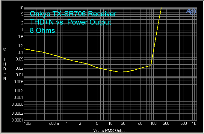

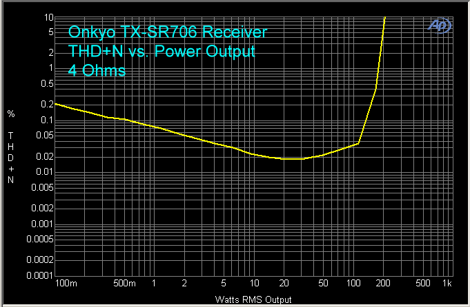

Steve81
Steve81
Audioholics Five-0
My thoughts on performance <1W:
Here's the power versus distortion of the mid-level Onkyo TX-SR706 receiver into 8 ohms and 4 ohms:
http://www.hometheaterhifi.com/images/stories/2009/march-2009/onkyo-tx-sr706-receiver-thd-n-vs-power-8-ohms-large.gif
http://www.hometheaterhifi.com/images/stories/2009/march-2009/onkyo-tx-sr706-receiver-thd-n-vs-power-4-ohms-large.gif
As most will note, THD+N is steadily on the rise by the time you're at the 0.1W mark (the lowest charted). On the 4 ohm chart, distortion reaches 0.2% THD+N at the 0.1W mark, or ~54dB below the fundamental signal.
Now my speakers are 4 ohm nominal (realistically, not as rated by the mfr), and have a sensitivity rating of 89dB w/ 2.83V or 86dB w/ 1 watt, and are at a distance of 8 feet from the listening position. Assuming an additional 4dB gain for being in room versus anechoic conditions and plugging into an SPL calculator, that 0.1W will net me ~72.5dB at the listening position, with THD+N at <20dB, which is well below the noise floor of my room. Food for thought, and of course different conditions may yield different results.

Steve81
Steve81
Audioholics Five-0
Somewhere along the line I seem to remember hearing that distortion levels as high as 1% fall into the range of questionable human audibility. Speaker distortion of 5% and for subs, 10% are pretty common ... leaving all that 0.1 and 0.2 stuff in the mostly unimportant category
The other thing to keep in mind with those graphs is that it's THD+Noise, and that at those low levels, the graph is more than likely going to be dominated by the noise floor of the system rather than objectionable high order harmonic distortion.
What's that? Is that like cross talk?
