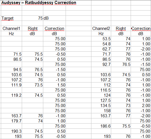

Here is my first attempt - still in Excel - so tranfering this table into RAT, saving it, transfering back to MultiEQ and uploading to the AVR, would be all what is needed - correct?
Yes, just enter the data in the Excel table to the Rat table, save it with a file name you can recognize. You should be able to copy that file from your PC to the MultEQ Editor app folder if the device you used runs Android. If it is an IOS device., then I guess it won't work like this and you will have to follow instructions provided by the MultEQ App for IOS. It should still be quite easy to do.
Based on those numbers, I think you probably should target 73 dB, in order to keep boosts to the minimum. At the end of the exercise you can simply increase the Sub1and Sub2 level by 2 dB and the L/R by 2 dB for the 20-200 Hz range to restore overall balance. If that works better/flatter than what you have now, then you can call it a day, but before that you may want to implement the so called "harman curve" as the last step.

Of course, if you figure you won't need more than 2 to 2.5 V pre out voltage during the highest peaks, 20 dB gain is great.
Yes that is correct.
Correct, Rat provides a table for you to enter the cuts and boosts, much better than drawing it by finger.
I am not sure what you meant by "by 1 dB", but yes I did apply the cuts/boosts to L and R separately for the range from about 100 to 6000 Hz (approx., going by memory..). For the 15 to 120 Hz range I believe I just did it for the subwoofer channel.
You can probably do all the prep work on the plane, or in the hotel lol.. One thing I suggest you don't do, that is, don't bother trying to run Audyssey again, as what you have now even without doing anything with the App and Rat is very good already. That tells me your room is actually pretty good, and you did a good job running Audyssey, doing all the right things I assume..
Thanks Peng appreciate the confirmation to the reference curve, RAT and Excel questions.
Actually I am on IOS and luckily it’s a breeze exchanging the ady files via the NAS (Synology) from the PC to the MultEQ app. So at least one problem avoided ;-).
Will definitely experiment with the 73dB target. The boosts shown in the Excel are currently only set at frequencies where I knew from the Audyssey Off REW FR that Audyssey had cut off a bit too much, so I would avoid boosting already boosted frequencies. Does that make sense or am I on the wrong path here?
In order to clarify what I meant by the L&R 1dB adjustment example I need to come back to you tomorrow so I can properly word and illustrate the question I had.
Thanks for the comment on the room setup. I am also a bit surprised as it is a modern and sparsely furnished room with concrete walls and even a ca 8x8ft floor to ceiling glass door. However as opposed to the simplified description above the right rear quarter of the room is open to a three times as large dining and kitchen area, which however isn’t much better dampened ;-).
So I guess keeping the KEFs as much away from the wall and the MLP choice helped a bit after all. Wall panels will be difficult but I might consider some for the ceiling and maybe a thicker carpet. Also, as I currently don’t run a subwoofer just the KEFs full range, would adding one or even two help for even better low frequency/mode control? What do you think?
PENG
Yes it makes sense to me too but it is still better to avoid any boosts. I would also avoid boosting the sharp dips but I found that it was possible to improve those somewhat just by boosting the nearby dips that are much wider as it would seem that in doing so, it helped lifting up the sharp dip as well. It likely was a hit and miss kind of thing though.
A couple of subs, even just one, will help a lot for sure especially if you have flexibility in moving the sub(s) to their sweet spots. Without subs, the best you can do is to try the port(s) opening/closing and settle on the best combinations guided by REW.
