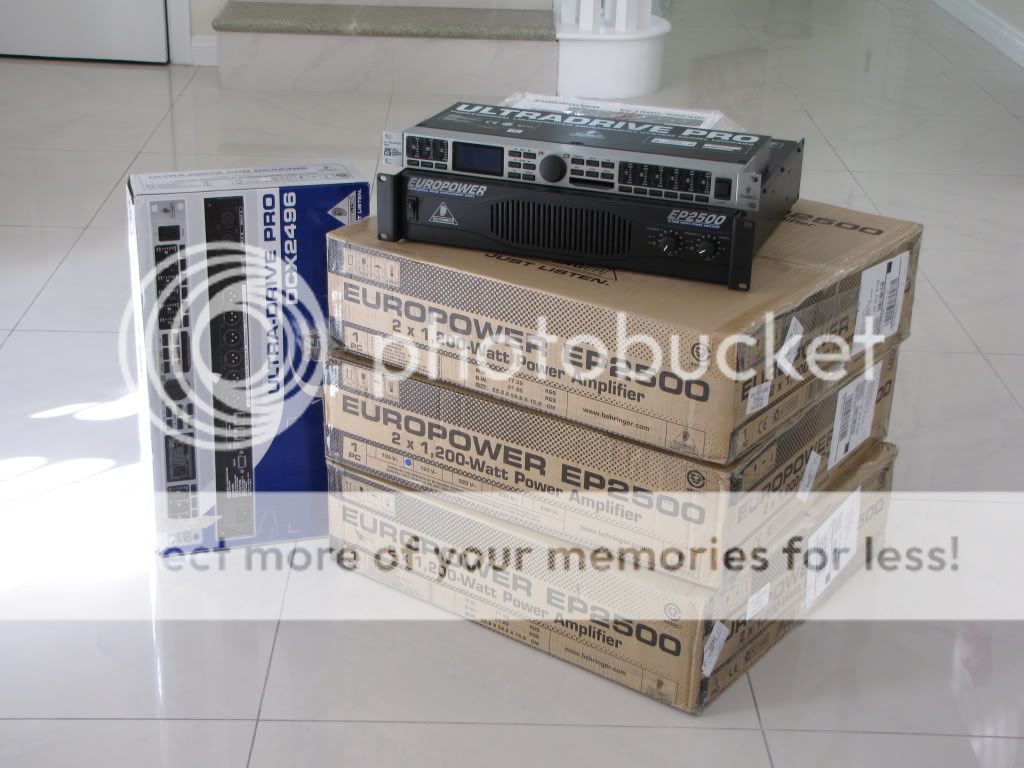

Behringer Pics
I hope you realize there a fees that come with Wmax's advice. These fees can be paid in the form of pictures of your equipment :D Or we can hunt you down and give you an offer you can't refuse(IOTW show us some pictures.)
Now why didn't I think of that?:D
Comming up next:
8 of the Dayton RSS390HF-4 15" Reference HF Subwoofer 4 Ohm
Wmax and I are discussing via PM a line array of Hi Fi transducers to complement the bass.
My neighbors are going to hate me.:D But that's nothing new.;)
