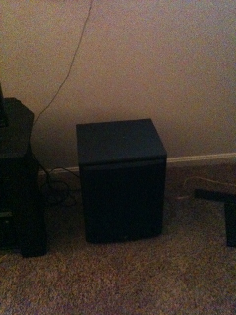

photo (8).JPGPhoto 5 last bit of equipment to be replaced with Kilpsch, is a 2005 Yamaha 12" sub #SW1 acquired along with YSP 800 sound projector for $1,500 in 2005 and now has little or no value (gave to neighbor) will be giving her this sub when I acquire its Klipsch replacement.

So you have a 20 year old mismatched center pointed at your knees and wonder why you can't hear dialog? I think you've answered your own question.
