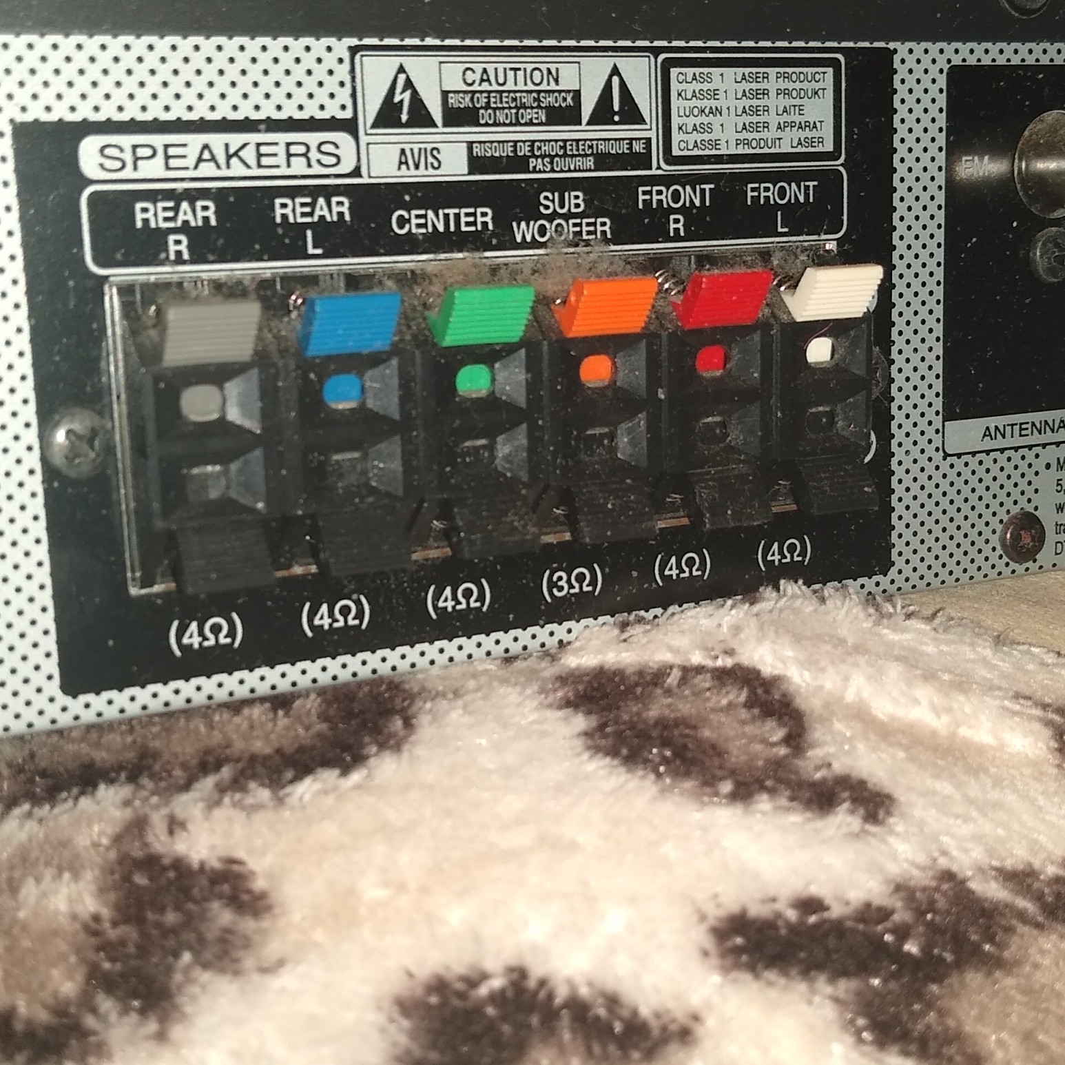

I have an lg surround system, I had it running with 2 front speakers and worked as usual, and I decided to connect the centre front speaker....when I did this the 2 other front speakers began to make a light bumping or tapping sound....from then on there is no sound whatsoever, the dvd player still turns on. Can anyone direct me to what may be wrong and if this can be fixed?

How did you connect a center? What is your source? Using an AVR or is it a HTIB?
Was the system powered on? Show the speaker terminals, if possible.

reply to all who answered me. I am unsure what avr and htib are, but I connected with the two exposed wires like all the other speakers. The model is LG ht503th. Um, if I remember correctly I actually do think the system may have been on when I did it yes tbh I regretted not switching it off first because I thought that may have been part of the problem, I did disconnect centre speaker as I thought this was part of the problem seeing the problem happened from the point I connected that particular speaker. I sent pictures let me know if this is what you meant
FWIW htib is short for home theater in a box (simple all-in one systems bundled with speakers). AVR is audio video receiver. Doing connections while power on isn't a good idea. You probably shorted something out, couldn't tell you what particularly.

You have an all-in-one unit (basically a dvd player built into an integrated amp); the amp is what powers your speakers (and sub apparently). Don't see much for your new unit but the one caution I'd say is that the LG looks to use a passive sub and are only suited for similar units where the main amp supplies the juice (most subs are active subs, i.e. have their own amplifier built into the unit and are not provided power from the central unit....this is somewhat typical of htib setups like this). The LG has low impedance speakers, so if the new Sony isn't that would be another caution but should work simply to test the speakers. Also start with the volume turned all the way down and go slowly...

It is an older sony htib system, my lg which failed was bought in 2011. Ok the speakers for the Sony are 3ohms impedance and the LG speakers are 4ohms impedance...... Is that safe to test the lg speakers on the Sony system ?
Yes, that's fine. Altho your passive sub is also rated 3 ohm on the LG.
