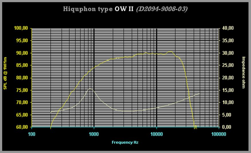

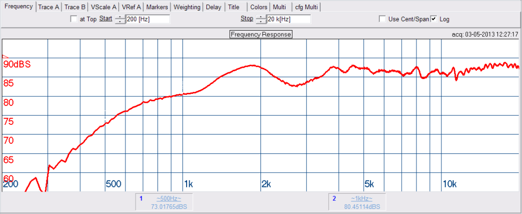

Hi Gene. I can show you the issue with plots of an 0W2 tweeter--one taken with Praxis, the other with Omni, and a third from the Hiquphon website. I can't insert them here because I exceed my space limit early on. But the factory plot shows a slight peaking above 14k, which also shows up in the Praxis plot. The Omni showns a gradual roll off above 12K. If you're interested, PM me and I'll get them to you via my regular e-mail.

Here are the measurements, straight from Dennis.
Per Dennis: "The yellow graph is the factory plot, the blue is made by the OmniMic system, and the red plot is Praxis. Don't pay any attention to the response below 500 Hz, and don't worry about
the dips in the response around 1800 Hz on the Omni and Praxis plots - those are diffraction effects from the cabinet edges."
