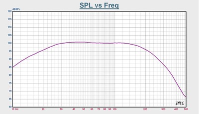

(SB2000 FR per SVS)
I think it stands a good chance of getting within striking distance for Audyssey (or whatever system your AVR has) to tame things.
Note that AH gave this sub a "medium room" rating which means it is well suited for 1500 to 3000 cu. ft. So you will have plenty of Ommph for your room. And definitely go dual if you can swing it unless you do not plan on having others over.
