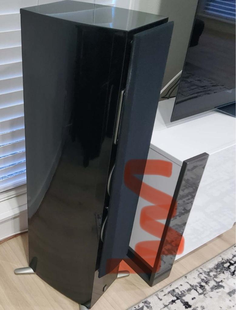

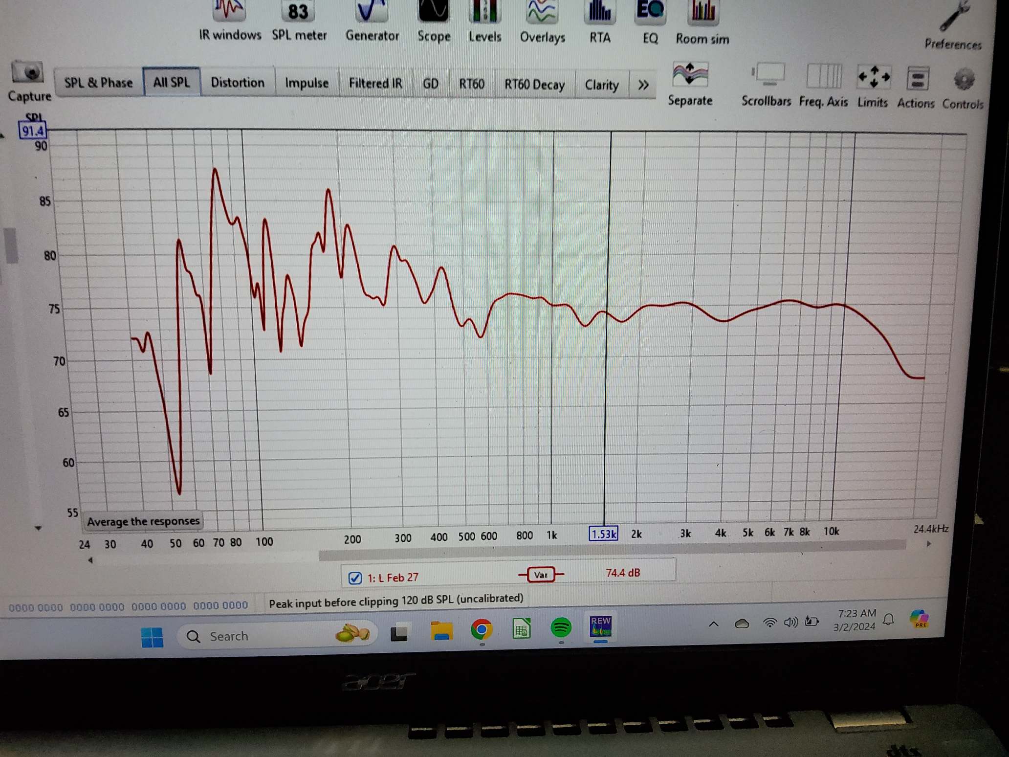

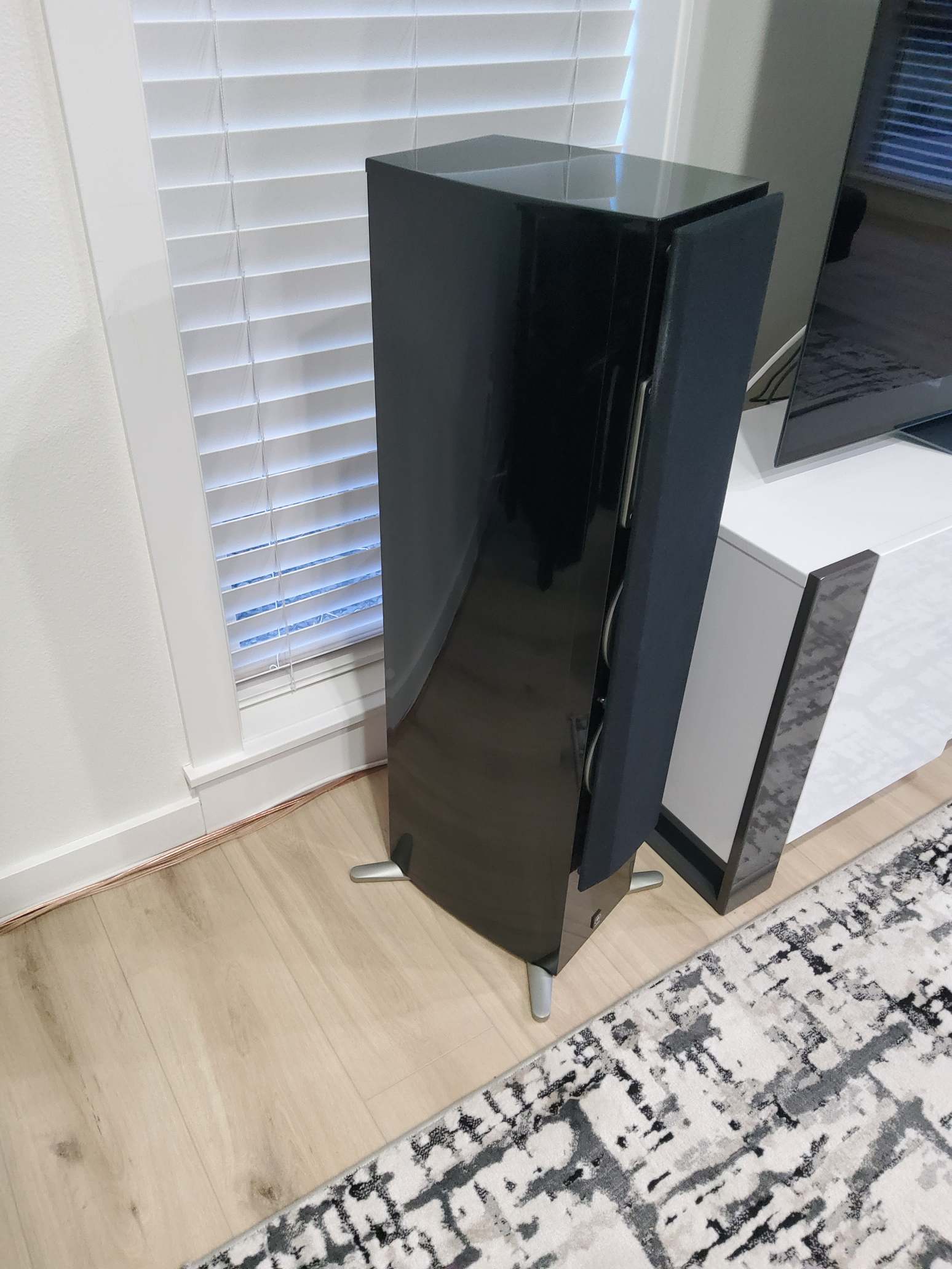

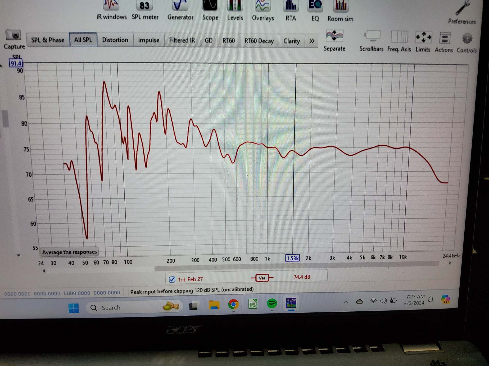

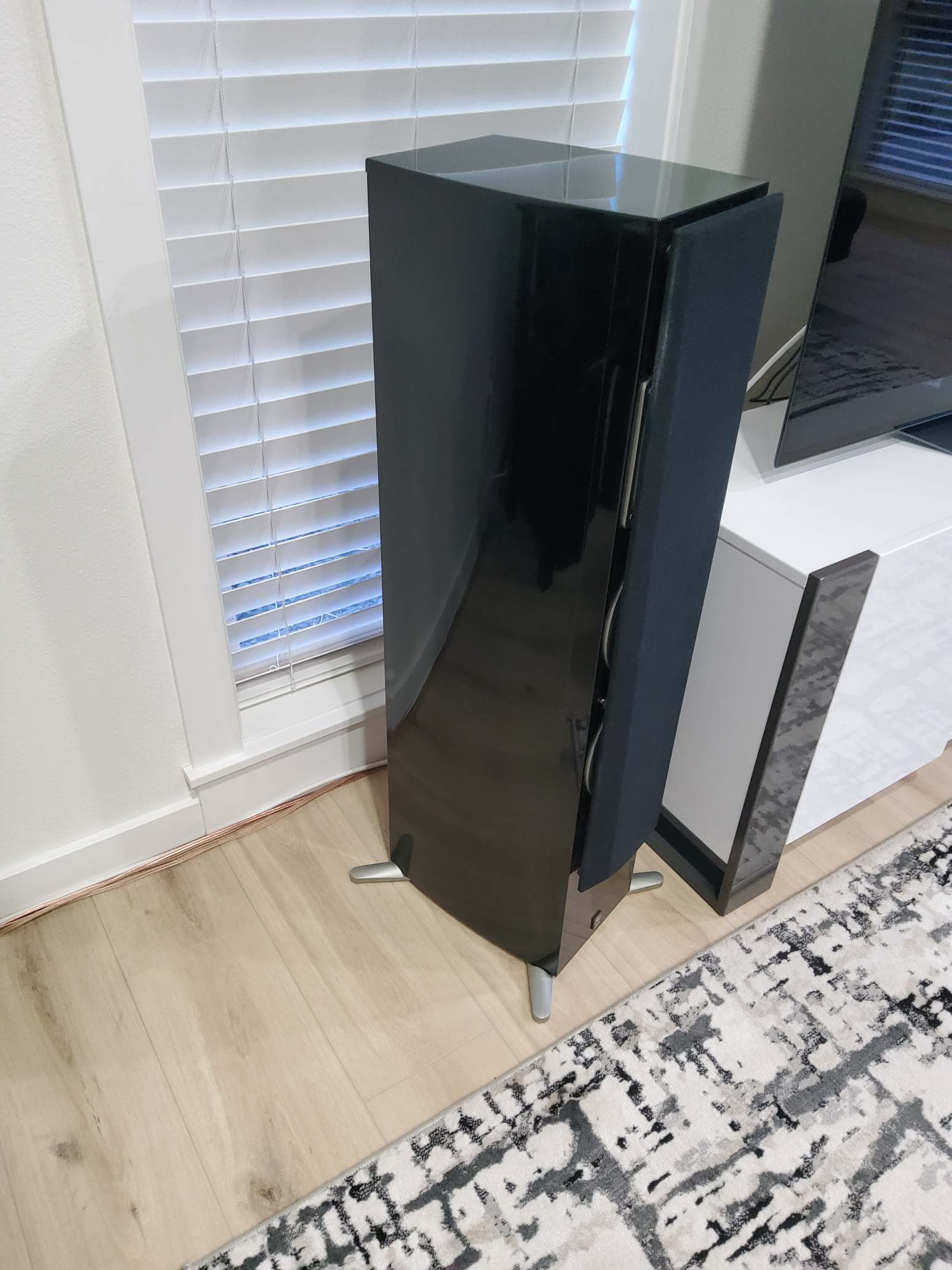

This is the position of one of my Yamaha towers. Not ideal, pretty close to a window. If I get the D17 or the R700, is one or the other more prone to give me weird bass reflections being so close to the window (the other tower is placed in a similar location)? As I said before, I have a sub and probably I'll use a crossover around 80 Hz and I'll set the speakers to small.
To give you an idea about the location, this is an RWE measurement of this tower, without sub or Audissey. I used var smoothing. The speaker has one port down, on the back.
I don't think these towers will fix those bass problems, but I don't think they will make them worse either. The locations of the ports won't matter too much here. The distance of any acoustic emission in low frequencies will cause these problems. You out to use the towers full -range in addition to a subwoofer in order to smooth out the bass response.
