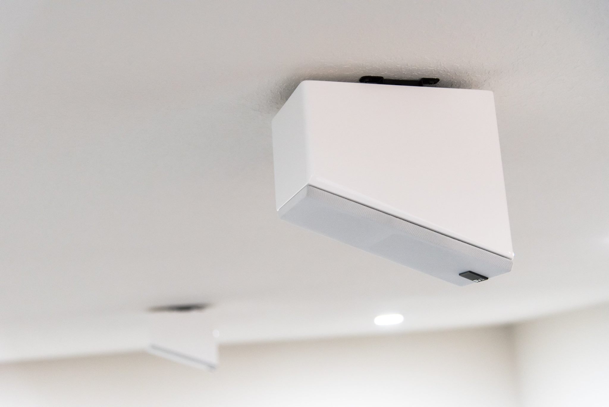

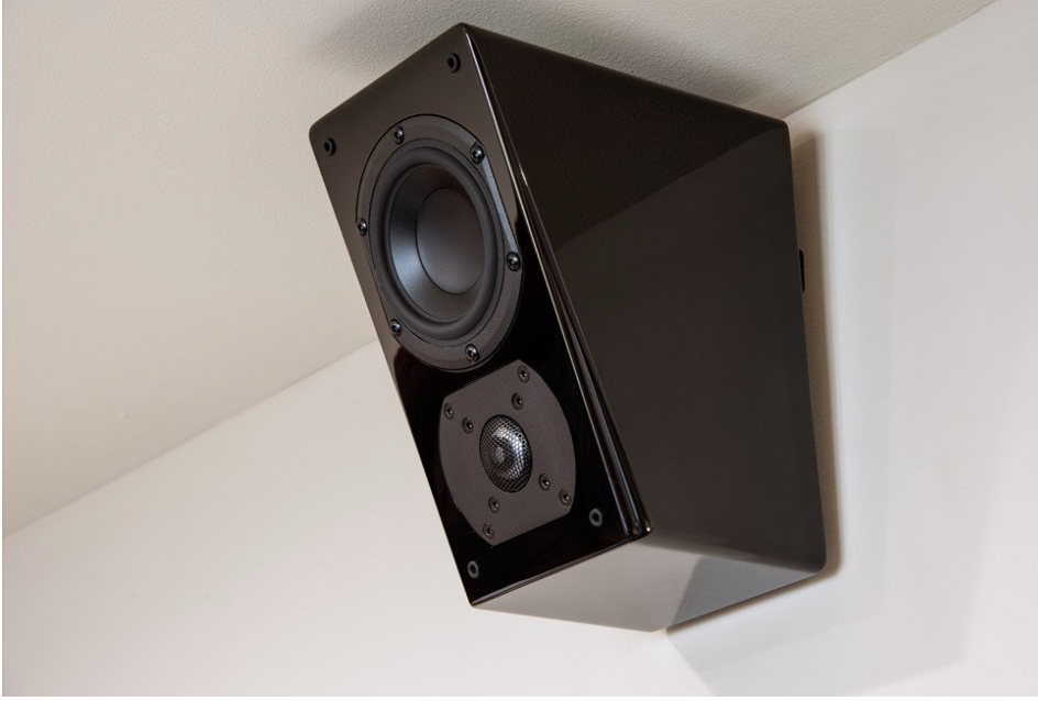

I just bought 4 SVS Prime Elevation speakers so that I could set up an Atmos system with overhead top fronts and rears without cutting holes in my ceiling. I had planned to ceiling mount them just in front and just behind my seating position as Dolby recommends. 7.1.4 Overhead Speaker Setup
Now that they've arrived I'm second guessing the fronts, whether to ceiling mount (Top Front Atmos approach) or use them as Front Height (like DTS seems to use more) mounted at the top of my front wall. I think the angle will hit my front seats regardless. I also think my Marantz SR6014 will figure out where they are regardless and adjust the delay and volume. I just wonder which would give me more flexibility with content available today? Any experience with these out there in different configurations?

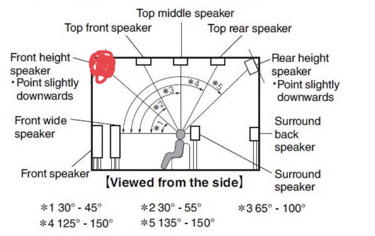

I would mount them up near the ceiling as shown in the image below if you want great ATMOS or Auro-3D sound.
Yep, that's the Front Height option. Why do you vote it over Top Front?

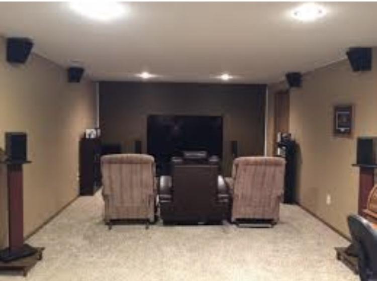

There’s another way to mount on the wall and get close to “tops” too. Mount high and to the sides.

And yes, I'm between that and this:
He mentioned auro 3D. There’s basically NO content, and you need a single VOG speaker in the center as well. IIRC though, Auro MIGHT phantom image between all four height/top speakers but if anyone is off axis, that’s useless as the sound will collapse to wherever that person is.

Personally, I prefer the front height install versus the overhead speaker. For me it provides better sound identification of objects.
It's really whatever you desire. I don't experience as much movie content directly overhead.

My height preference is based on music and movies. Denon receivers offer settings for both configurations. It's obviously a topic of choice.
Here is the Auro-3D setup. Its recommended to locate the speaker near the top of the wall and one overhead.
Denon also displays locations for overhead surround speakers in the image below. They are different than front height and rear height. You will notice the top surrounds are down firing instead of angled..
William Lemmerhirt
William Lemmerhirt
Hit your seat because the angle of the baffle? Or because they’re close to the angle.
This is the “other” option I was trying to describe.
