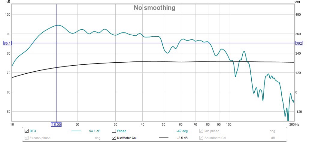

You load the program into your computer, the mic via usb connection to your computer (older style mics used the sound card but that's more work, use a usb mic).
William Lemmerhirt
William Lemmerhirt
Room EQ Wizard is a measurement program that many use to dial in their systems... it helps analyze the acoustics you experience in your room much more accurately than Audyssey does, for example.
Exactly. And graphs look like this(just one I picked from camera roll)
So this is the result of a sweep tone. (I run sweep tones from 10hz to 200hz. It only lasts about 5seconds) So in this image, you can see the area between about 48hz and 60hz is lower in output than the rest. So, providing I have the space I would move the sub around and sweep again to check my results. This could create other issues in other areas so it’s important to sweep every time you move the sub.
This is what it might look like after good placement and eq, either built in or minidsp and/or audyssey.
You can see it’s flatter. That’s what people mean when they say “flat” response. (Disclosure, both graphs are post audyssey/minidsp)
William Lemmerhirt
William Lemmerhirt
This is kinda what an REW sweep sounds like. Except measurement sweeps are shorter.
I just ordered this mic, will probably have more questions of you once I get it and get the program going. So this helps you set your different volumes for each speaker basically?
It helps analyze audio in your room. You can use it as a simple spl meter, or you can analyze the whole frequency range. And more. Lots of good info at the REW website https://www.roomeqwizard.com/
