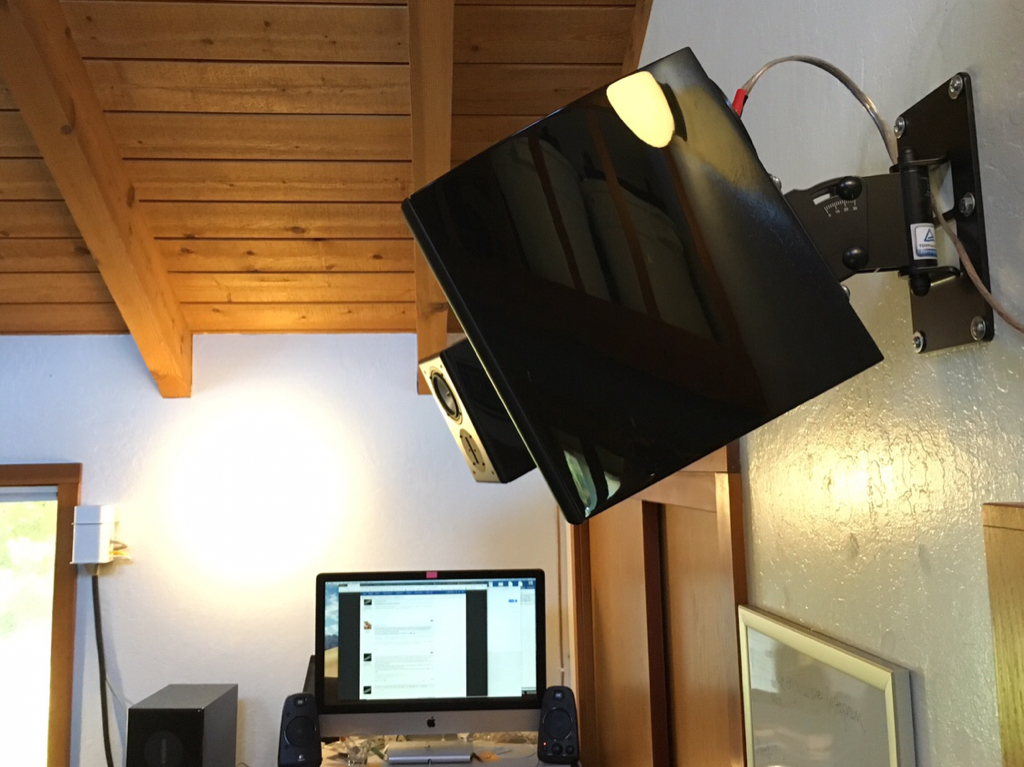

Here are my rears. You can see the top of the open door in the lower right, and top of my Right Surround next to the computer.
Nothings ever perfect, we just work with what we have to make it the best we can!!!
