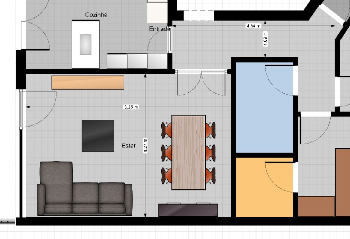

@Pogre
Portuguese representative sells each unit for 600€ (PB-1000) , so it would almost double my budget . maybe if i buy them two the are able to make it 1000€
attached a part of my apartment with some dimensions.
the door opens to the corridor.
thank you
Are BK Elec subs available to you? UK made....
i live in portugal so im not sure due to brexit... i always considered them as entry level subs, but probably im wrong
I was wondering how brexit might affect that but I'd think currently there'd be minimal effect. The SVS and Golden Ear subs you're considering are also entry level. I haven't seen any third party testing of the Golden Ear Super Sub-X but I just can't get excited over tiny subs like that (unless you're in a small room/office perhaps) especially costing that much. They are very small, and sometimes that can be attractive to some; I don't have any size restrictions to consider for myself generally, do you have any particular restrictions on the sub size itself?

@lovinthehd i dont have any particular restrictions. Some days ago i saw a second hand SVS PC-13 and was considering on buying it. But then, seller warned me about the size and after some measurements i changed my mind :').
i was looking for something around 50x40x40, dimensions near the subs you have shown me. much bigger than this would not be adequate for furniture on my room :).

The XTZ Cinema subs should be solid, as well as the Aurandal THX subs. Both are made by the same manufacturer. Other subwoofer lines from those companies may or may not have QC issues, but the Cinema subs from XTZ and the THX subs from Aurandal are going to be very good. Might be a bit expensive though. From Paradigm, look at the Defiance X series. Look at the Defiance X12 or Defiance X15, but are really good subs. Probably are't really cheap though, but the truth is, in your neck of the woods, no good sub is going to be cheap.
