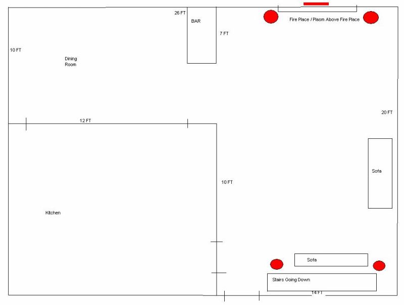

I only have a 6.1 receiver and I'm getting a pair of Axiom QS8's that have "Multi-directional Quadpolar Technology". I'm just trying to decide where I'm going to put my surround channels at. I currently have mine on stands right beside/behind the listener. This works for now until I get the QS8's. I think that I'm going to just try and mount them on the sides like everyone suggests. Here's a quick drawing of my space.

Uless it is a mounting or asthetics issue, place the surround speakers on the sides per the dolby spec. The sound track was mixed for this intended configuration and your ears can hear sound comming from the sides better than the can from behind you.
The quad-pole design of the QS8s does make them more flexible for placement than your typical monopole speaker but it desn't look like there is much room behind the listening position.
j_garcia
j_garcia
How big is that plasma? Sitting almost 20ft away puts it really far away.
I'd put those surrounds above and to either side of the couch. With them closer to the rear wall, proper level calibration is going to be important.

I would move your monitor to one of the side walls and put the sofa on the opposite side wall.

If I were to do that, I wouldn't get the sofa centered with viewing area. I looked into everything and the way it's setup right now works well. I have a 43 inch Plasma right now and I used to have a 28 inch tv prior to, so that's not an issue either.

Twenty feet is WAY to far away from a 43 inch screen. Maybe you could move the couch to the center of the room and use it to divide the room in two. Make a separate seating area in the back half of the room, or put a game table back there.

Too far for 43 inch? You should've seen it when I had my 28 inch tv up front and in the corner. I'll see what I can do with it, as the wife is incharge of the decorating.

I hear you about the wife thing. Sometimes a large room like yours is too big to place all the furniture along the walls. Another option would be to get a corner couch and place it about mid-room. That's what my wife and I have except it is made up of two "love-seat" sized sections joined by a corner piece.
