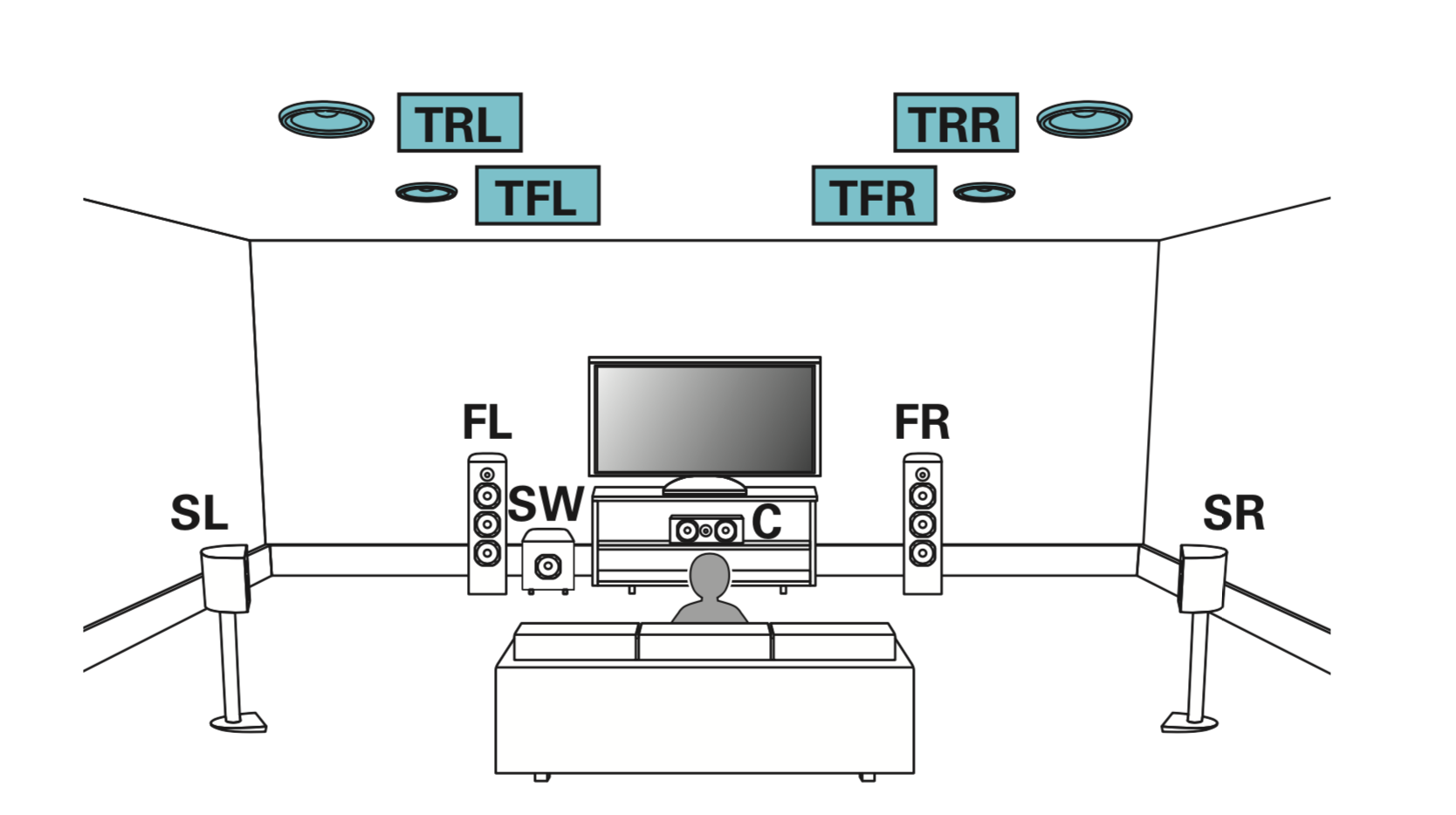

If you are going with ceiling speakers I would look for something that acoustically matches the main L/R for front height and rear height speakers.
This setup can be used with movies and music using Auro 3D. Auro 3D is currently my favorite surround mode for listening to music. It engages on the Denon receivers when the height channels are configured. This mode uses an Auro-3D decoder to create three-dimensional audio output. Even if the signal is not encoded as Auro-3D an Upmixer called the Auro-Matic is used to create highly realistic three-dimensional audio output. It's a great sound mode option.
