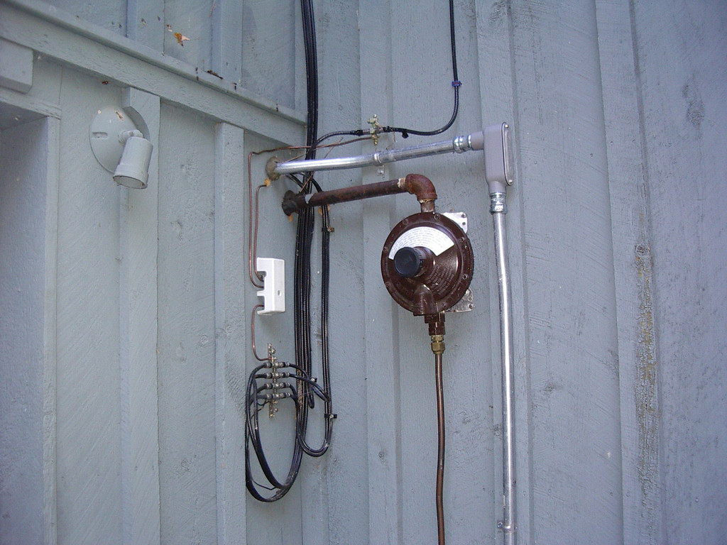

Here is my Direct TV grounding system, as well as the FM antenna grounding block tied in.
There are four runs to the roof for Direct TV as I have two DVRs. The small grounding block is for the FM Yagi Udda array.
A closer look. This is not how the Direct TV guy left it I can assure you.
Here are the three seven foot copper grounding rods, all tied in. You can see the House ground and the grounding block ground both going to the grounding rods.
That's how it should be done, if you don't want hum and buzz.
