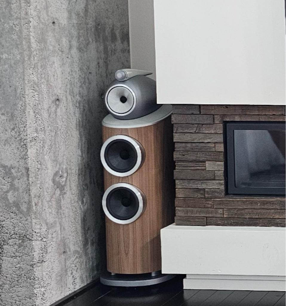

I completely understand your perspective. Unfortunately, sitting closer than 10 feet isn’t going to work out. Attached is a picture showing the current setup with a 50-inch screen. To improve the viewing experience, I plan to upgrade to a 98-inch G4 or whatever newer model is available. For now, I’ve purchased a 77-inch TV as a temporary replacement for the Pioneer.
I’m also considering settling for a 2.1 system and adding an SVS subwoofer. However, if I need a center channel, I’m not sure what to choose—I’d prefer something wall-mounted under the TV.
So far, we haven’t been able to fully enjoy movie audio. The current setup—using the PS4’s optical output into the preamp to feed the amp connected to the B&W 803s—has been great for music, but not ideal for movies. The biggest issue is that when the volume is adjusted for vocal clarity, action scenes become overwhelmingly loud, forcing us to constantly adjust the volume.
I don’t currently have an AV receiver in the setup, so I ordered a Marantz Cinema 30 to enhance the surround sound. However, I’m wondering if it might be overkill for what I need—something smaller might suffice to improve surround sound and audio clarity.

Hi all, Ok after a lot of thought, I'm replacing the front 803S with 802D4 and a parasound JC5. I will use the 803s as rear a surround, and the svs Ultra17 as a Sub. I'll post the pictures as soon as I have it all setup. I still have not found a discrete solution for the center. May be a high center that is above the TV?

Yes there are massive motorized double curtains in front of the glass facade. No echo in the living room. I will be moving the 802D4 slightly out from the recess. Kids are grown up now, so I don't fear the new ones being tampered with. Only I need to find a solution to repair the 803S tweeters. They sound fine I think. They look ugly at the moment.
Once everything is setup. I will give the audessy out dirac on the marantz cinema 30 a try. May be it might improve the over all audio experience. Can't be worse can it?
