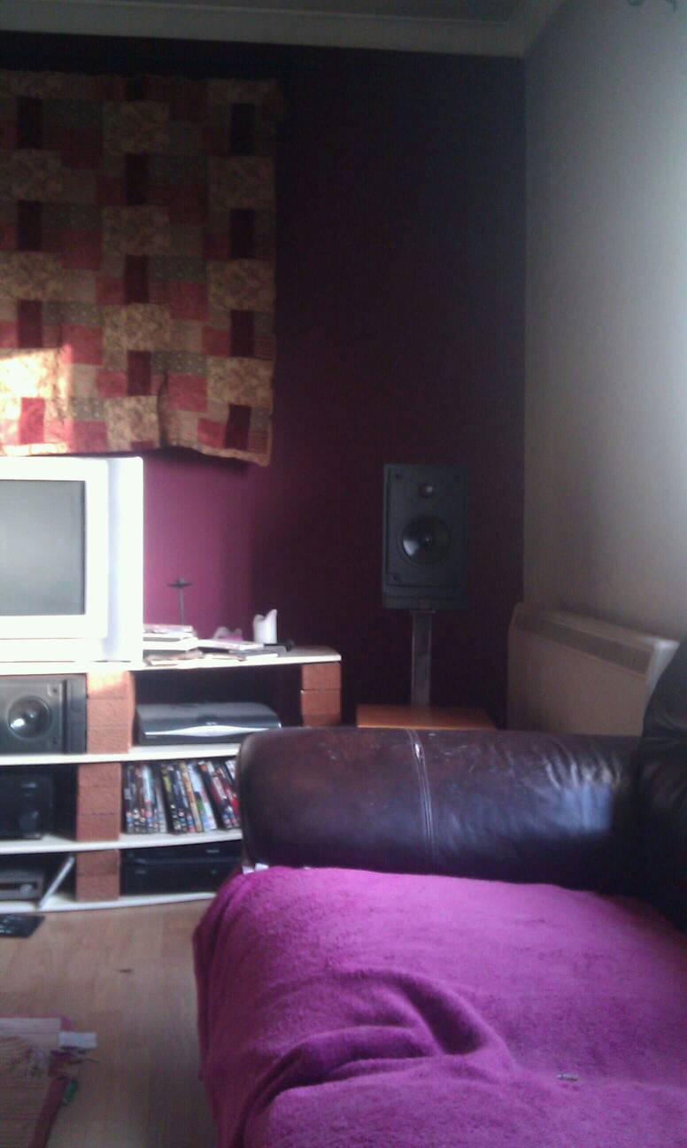

Would eggshell type packing foam be any good...i've got some in the loft and i'm looking to do something about the end of my leather couch ...which i'm guessing is causing some issues

Sorry could you elaborate a bit more? What exactly about the end of the couch is causing issues? And what type of issues would it be causing?
Packing foam is useful for packing/shipping. Packing foam is also typically not fire treated and typically lights ablaze instantly. I wouldn't recommend it on your wall unless it's been rated for that use and is tested for acoustic absorption. Otherwise its equally as useless and hazardous as blankets on a wall. (Though some blankets might not catch fire as fast as some packing foams)
twoeyedbob
When running test tones on receiver it almost sounds
Like there are 2 sources from this (rh)speaker,i'm presuming the leather couch is the cause .... The side/end of the couch is unseen from normal use

Ah that makes much more sense now.
Yes, the reflections in that small area could create a seemingly second source, but leather would only be reflective of high frequencies. Most lows would just pass through. You could absorb on the side of the couch, but IMO a better solution would be to simply move the couch back more if you could. A small end table could break up reflections easily - anything really that isn't a flat surface will scatter sound enough to prevent that late phantom source. If you were to treat the room, bass trapping and early reflections would likely make the biggest difference, not just absorbing the side of the couch.

Unfortunately the couch is already tight against both wall's..
I Was considering building some accoustic panel's for behind the speakers and/or listening position but
Anything involving the side walls is a non starter.
As This is my wife's room as well ,any treatment may be a non-starter :-( .
I thought that the eggshell shaped foam may break up the reflection's to an extent,although i suspect the flat arm of the couch is the main culprit...i could relocate the subwoofer if you think that may help ?
there is an magazine rack behind the listening position which may be ideal as some sort of accoustic treatment

Panels behind the speakers would help with SBIR. I would definitely suggest panels on the back wall, especially if you can't get any in on the side. Foam could help on the side of the couch, but I'm still not too sure if it's the cause of the phenomenon you're encountering. You could try a simple thick comforter on the area just to ballpark if that is the source of the problem or not. If it is, then yes a small panel or foam could help.
