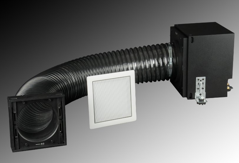

My choice would be in room subs with this...
The Hideaway Theater
It’s mostly for tactile response, and delivers couch shaking power below about 20hz, but you can set the slopes however you want. Some people do use it with the IR subs off as to not wake anybody else.
