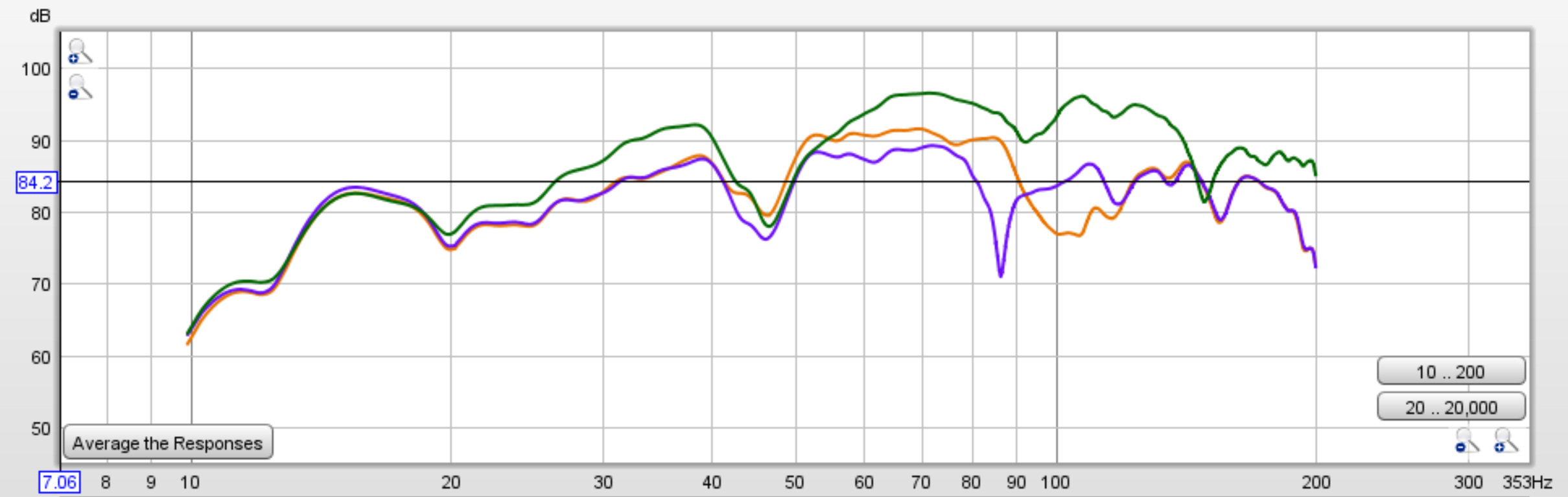

Disclaimer: I'm a REW/measurements newbie, so can't claim how accurate these are. Still reading up on best way to measure things. Used UMIK-1 minidsp microphone.
Took some REW measurements to help with the discussion. I tried multiple variations with the Hsu including 1 port open, 2 ports open, and no ports open (sealed). Also tried phase 0 and 180, and of course various cross-over settings (80 to 200hz).
1 port open was always the best, measurements were the same for all 3 except drop off was more rapid towards 20hz with other 2 settings. I thought sealed was supposed to be more flat and longer roll off at 20hz? *shrug* 150hz crossover and 180 phase measured the best, got rid of a significant dip around 85hz and increased db by about 10 from 100 to 140ish hz, so good call out on increasing crossover. But 40-50hz still has a big dip...
Follow-up questions:
  1. Would having tower speakers help or does it not matter vs. bookshelves for mid bass?
  2. Would buying a minidsp help get the curve I'm looking for? Not very flat, and I believe it should be slightly raised towards 20hz for best results, so I've read...
  3. Would buying a second sub help? Basically same as question #1.
I attached 3 of the measurements that I thought would best represent my testing, showing variations.
  1. Green = 1 port open, 180 phase, 150hz crossover, audyssey on
  2. Purple = 1 port open, 180 phase, 80hz crossover, audyssey on
  3. Orange = 1 port open, 0 phase, 80hz crossover, audyssey off

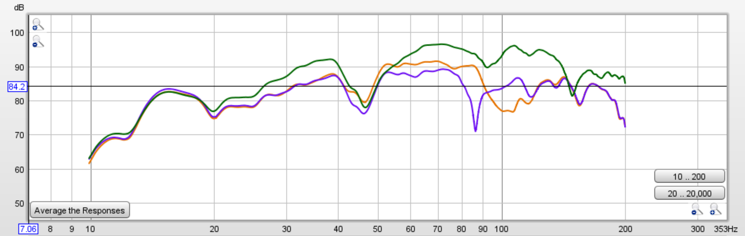

Those responses aren't terrible for in-room responses. I have seen worse. Your most significant problems are the dip at 45 Hz and wider Q dip at 20 Hz. The thing is, those are not 'chest punch' frequency ranges, so addressing those are not going to get you what you are looking for.
To answer your questions:
Tower speakers will have significantly more powerful mid-bass than your bookshelf speakers. Way more displacement in the mid-bass frequency band.
MiniDSP might help if you have multiple subs, but it won't be able to do much with your existing response. That is because your problems is nulls rather than peaks. Always use EQ to trim peaks rather than shore up nulls. The best way to address nulls is adding another sub which does shore up the null region.
As far as adding a second sub, I know this is a pain the in the a**, but can you measure the sub in the other available placement for it? If that placement response fills in 45 Hz and 20 Hz, then yes, add another big sub.
Another thing, if you are looking for what SPLs are needed for chest thump, in the REW tone generator, select 'CEA-2010 Burst' and run tones at different frequencies and also different levels. Work through through the frequencies using the 'Previous 1/3rd octave frequency' and 'Next 1/3rd octave frequency' button, so 20Hz, 25Hz, 31.5Hz, 40Hz, 50Hz, 63Hz, 80Hz, 100Hz, 125Hz, and 160Hz. 160 is the highest that will be useful here. Use lower and higher crossover frequencies for the sub to see how the sub compares to your speakers here, so use an 80Hz crossover frequency and also the highest crossover frequency that your AVR allows. You can raise the sub to maximum volume for this exercise since you are just looking for what constitutes 'chest thump.'

Thank you for suggestions. Good idea to try moving the sub around and verify I can cancel the dips before buying a second.
Wasn't aware of the CEA 2010 burst. I will look for it and try it.
