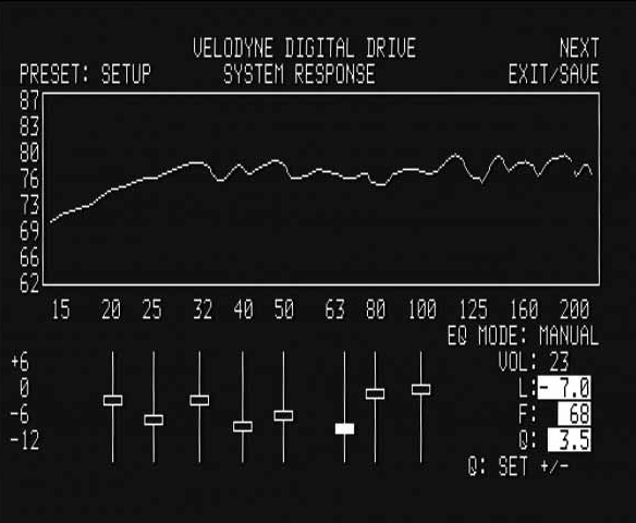

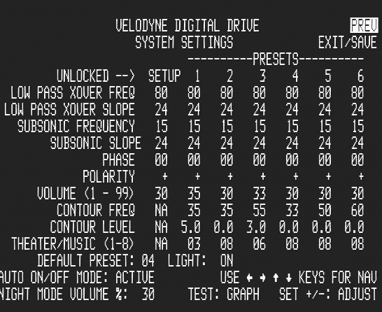

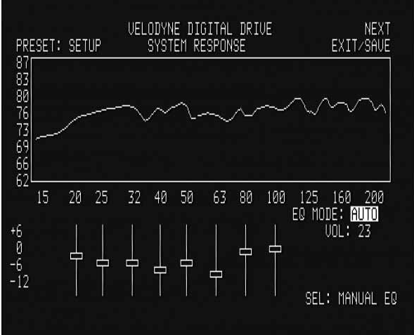

Thanks for the feedback. The only equipment change was the receiver, but I did end up moving my sub a few feet (as an experiment) because it just wasn't sounding right. So after moving it, it did sound much better. Then I re-ran Audyssey. I don't understand Audyssey enough to know what eq changes it makes to the sub, tho.
The Velodyne setup can do eq for the sub, I'm attaching a few pictures for example. As I haven't really run the sub's set up process (still reading up on it), I want to make sure it doesn't work at cross purposes to Audyssey. It basically does a sweep (using it's mic and test tone), and then provides a way to adjust resulting curve.

Thanks for getting back to me. I'm attaching some pictures of the sub's setup menus.

Thanks, sounds like it might be a good idea for me to run the sub setup software first, then re-run Audyssey... I've attached some pictures of the Velodyne's setup menus in a couple of the other posts in this thread.
