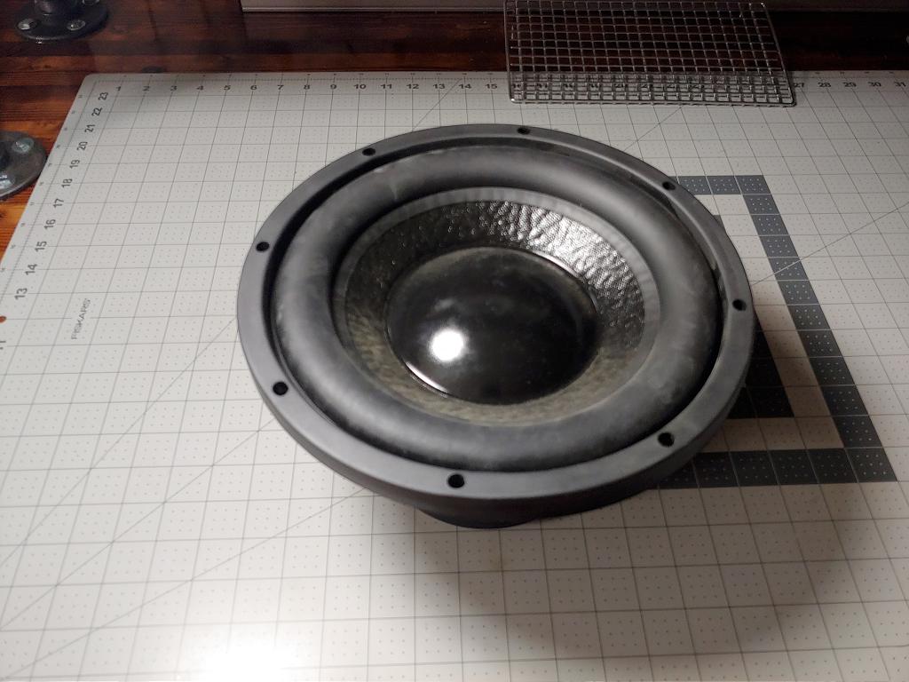

Hello everyone. I have this subwoofer that broke about a week ago. I emailed the company that I bought it from to ask about purchasing a replacement and that would basically cost me $300 +SHIPPING US dollars. That's something I really don't want to do.

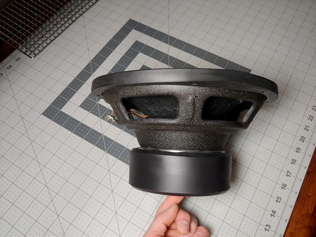

It's a 10" woofer from a Adams Audio Sub 10 MKII. What broke is the spider damper, I think it's called. It broke away from around the tube thats attached to the cone? I dont know much about speakers and all that. What I do know is how to work with my hands. I havent taken it apart yet.
Does anyone know where in the states, preferably, I could buy a new spider damper? Also, what type of glue is used to get it all together? Anything else I should know?
I attatched an image. I had to drop it down a lot to get the file size down to attach it. If there's anything you could tell me that would be great.

You can try to fix that with this stuff, but I wouldn't expect too much. If the cone was overdriven so badly that the spider detached from the former, it may no longer be aligned correctly anyway. If it were me, I would just order a new driver, or a entire moving assembly piece at least.

Whats the driver? I don't know if the company will sell me parts. How hard would it be to install a new spider damper? I have to keep that tube in there aligned so that it doesnt rub inside the magnet?
This happened while I was watching a movie. I forgot what movie I was watching, but apparently is had some stupid low frequencies because the cone was flexing in and out real far. when I saw this I turned the woofer down but then noticed I just had to turn it off.

If you are used to repairs, you could recone that driver. You will need the cone which comes with attached surround, VC and spider. You will need a new dust cap, factory shims to align the VC in the gap, and loudspeaker glue. It is not that difficult. Parts Express are pretty hopeless in recommending replacement drivers and make nonsensical recommendations.
That sub has a down firing port. So the enclosure will be designed for that driver only. It seems a really well made driver with high excursion. I think $300 is a very reasonable price for that driver.
Any replacement driver will not work unless it has the exact T/S parameters, unless the cabinet is rebuilt. Unless you know the T/S parameters of that driver you can not begin to look for a replacement.
Since you have destroyed what looks to me to be a very well made powerful driver, then I think you are actually looking for a more powerful sub. I see that sub is aimed and sold to the pro studio market mainly.
That spider you have destroyed looks much more robust then typical offerings.
If you just replace it with another non identical driver you will, not might, waste your money and be further behind.
If you do replace that driver with the correct one from Adams, then you will need to play at a lower volume. If you are unwilling to do that, then you need a bigger and more powerful sub. That will cost you more. You could also build a sub. Those are your only options that will have success.
