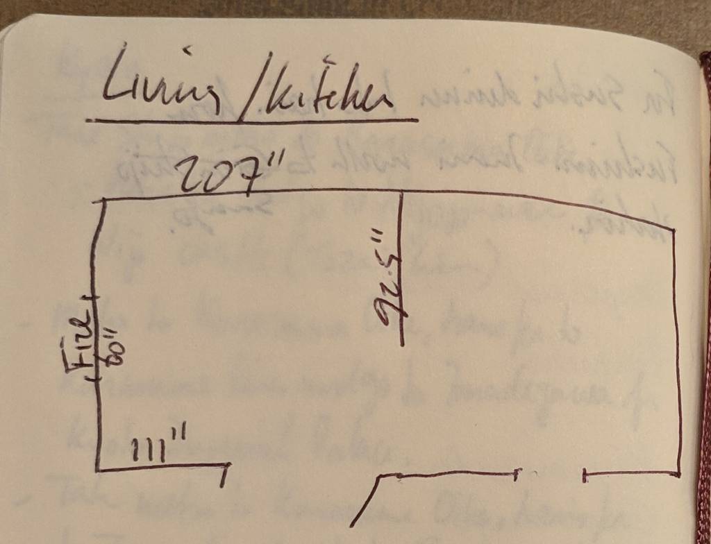

I have Revel F35/F36 on my shortlist for speakers I'd want to get and will probably want to pair it with a good affordable sub. Want a 2.1 setup mainly for music.
What are some good subs I should be looking at around $500. I don't know too much about subs, is it better to get a vented design or sealed? What other factors should I consider.
The back wall for the speakers is about 9ft long, with the right wall being ~11ft long. It'll be in that corner I'll place the sub, with one of the speakers right next to it. The left side is open (no wall) and leads into the kitchen and front living room. Back wall is about 17ft long until it hits a half-height divider that's about 8ft long, and then beyond that is the kitchen area.
In the attached image, the corner I'm referring to is in the bottom left.
Thanks!

I would go for a vented design, and one that digs deep in order to justify adding a sub to speakers that are already so capable in low-frequencies. In the $500 range I would be looking at the SVS PB-1000, Monoprice Monolith 10" THX Select, and the Hsu Research VTF-2 mk5.

Thanks. And is placement in a corner like I proposed generally a good thing to do?

Corner placement is generally OK but don't get hung on it if it doesn't sound great. My advice would be try different placement throughout the room and keep it where it sounds best to your ears.

In my experience, corner loading is not always good. I highly recommend doing the Subwoofer Crawl to experiment with how it sounds in your room. Since, as Shady said, you already have 2 good sources for some LF on your front wall, I would recommend experimenting with placing it on the sides or back wall. This will spread out your Lows and help even out the response a touch. (Yes, even though you will be crossing the subs at some point, say 60 or 80 Hz, as an example, your speakers and subs will still be reproducing the same information and having some space between them will potentially help avoid any nulls and cancelations in FR.)

Thanks for all the advice everyone. I'll probably go for the Hsu and will also experiment with putting it in the back corner (so instead of front right, in the back right).
And based on what ryanosaur said I'm even more inclined to just go for the F35, might be a better overall balance if I'm getting a sub. But perhaps I'll just get the speakers first, and a sub later, and first see if I even need a sub. It's a relatively small space and maybe the room response will boost the lows enough to my liking for (for music purposes). But I do like the idea of adding a sub as with some of my music there are some very deep bass notes that on many speakers sound rolled off (the notes sound softer when really they should be at the same volume, if you will, as the higher bass notes that are above 50hz).
