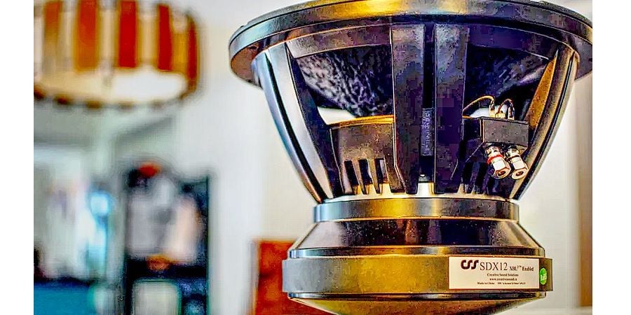

Hello,
I have recently added two css sdx 12” subwoofers up front each with its own crown xls 2002 bridged ( 2100 watts ) and two css sdx 10” in rear powered by a behringer km 1700 ( about 400 watts per ch.) all In sealed enclosures built to spec.
My front speakers are 3 Boston acoustic vr m90’s and both My side and rear surrounds are Boston vr m60.
The bostons are powered by a Yamaha rxv 2700. With a mini dsp HD.
My room is L shaped. The main part 14 x 18 with a 9x 10 making up the smaller part of the L shaped room.
My question .
I assumed I would get more volume out of my subs . I have to turn the gain down through my reciever on all my speaker to -4 to level match my subs.
If I turn the the gain on my crowns past 3 o’clock I get clipping and my subs can bottom out .
I do have the output gain sat on my mini dsp Hd set so that at max volume on avr ( I limit it to -10) with Jurassic park scene I use to test limits I don’t go into the red with the gain.
I love my set up and I think the css sdx subs sound great but I feel like I am doing something wrong and my output is suffering .
Are my expectations to high?
I bought the crowns because they claim 2100 watts and my subs are 1000 watts rms so I thought I would have plenty of headroom but I seem to be at the limits . I do have my crown amp sensitivity set to the lowest option .
Also the two sdx 10” running off the 400 watt behringer are only a couple of db below the 12” sdx running off the 2100 watt crown.
Just doesn’t seem right.

We are missing vital information from your post. That is, what enclosure are those sub drivers in? Your Yamaha has enough voltage from the sub out to drive those amps.
So I have to conclude that either those sub drivers are in the wrong box, or that you have them in a sealed box, but have not provided the requisite 12 db per octave boost below F3, and the high pass filter at xmax to prevent over excursion is they are in the optimal sealed box.
The 12" drivers are capable of an F3 of 24 Hz in a ported box, but 45 Hz in a sealed box without appropriate Eq. I have not modeled those drivers, but that is the info from the spec. sheet. If you just threw those drivers in any old box that is your problem. Sub design is an art that has to be learned. Other speakers are even tougher.
So you have only provided details on the sub driver, and that is not even really half of the sub equation.

Thanks for responding.
The 12” sdx are in a 1.2 Cu ft. Sealed boxes. and the 10” sdx’s are in a .75 cu ft. Sealed boxes. I chose the sizes from the css recommendations for a qtc of .707 for the 12” and added foam board to the 10” to get .75 cu ft. For the 10” because I found the css recommendation of 1. Cu ft for the 10” to big and the 10” would bottom out.
I set my high pass for 27 hz for the 12” and 28hz for the 10”. The 12” have a 5db boost at 30hz and the 10” have a 2.5 hz boost at 30 hz. Per css recommendations , but lowered the boost on the 10” to protect woofer.
The rest of the eq remains flat.
I chose theses numbers both from the audiobook s article about the css 12” and from calling and speaking to someone at css.
They actually recommend a high pass at 25 hz but I moved it up for added protection.

Output Volts from mini dsp Hd is 2 v but if I set sub amps at 1.4 v input I get almost no volume so I have switched the amps to .75 input volts . And made sure the input and output on the mini dsp doesnt get into the Red on clip meters. The amp clip meters never get to red .
Avr output is 2 v and I have it set to 0 db gain on the Yamaha receiver.
thanks
I did not get the kits but I built the box’s to the same dimensions as the kit
Well, you should have come here first. Those drivers have far less than ideal Thiele/Small parameters for a sealed design and will not work well in such an application. You have inadequate Eq, but I suspect the drivers will not tolerate more. Sealed enclosures are very inefficient as you have found out.
So you need to get your tool kit out, and build ported boxes for those drivers. If you want I can design optimal ported enclosures for you.

As promised I have modelled your drivers.
The first point I would make, is that the size of the box is critical to maximize output. Otherwise you reach xmax at a lower power or limit bass output.
These drivers are only suitable for closed box alignment. For ported, the ports are far too long and you will have port resonance. For passive radiator the device has impossible parameters.
I can see why you are having the problems you have. These drivers are actually not all that powerful in the sub range and become power limited. When a manufacturer quotes a power they generally do not state at what frequencies they will take that power. You will see what I am talking about in the attached graph models.
You can see that both drivers require a 12db per octave boost below 50 Hz. You can see that the drivers need protection high passing at 25 Hz or thereabouts.
Now we get to the thorny issue of power handling. The max output of the 12" at 25 Hz is 103db and for the 10" it is 100db.
Now maximum power handling. The 12" can handle 150 watts at 25 Hz before exceeding xmax and getting distressed. The 10" unit can handle just 30 watts at 25 Hz before distress. It actually needs high passing at 30 or 35 Hz. To be honest that driver is pretty useless as a sub driver.
The motor systems of those drivers are not among the best designs. You can see that by the humped response. So the motor systems would benefit from shorting rings.
I return to this point often and that is, that driver selection is always the first step in any speaker build. You have to set your goals and then model drivers until you find one or a number that can fulfil your design goals. If this is omitted, then you will almost certainly be in for a disappointment.
Frankly I would not select either of those drivers for any sub project I was involved with. I really can not sugar cote that news, and in any event that would not be helpful.

Thanks ,
interesting results
I did do a fair amount of research before I bought them including a article from audioholics . This is from their article
“The measured performance of the CSS SDX12 subwoofer is excellent when you consider its price and size. There are other 12” subwoofers that will outperform the SDX12 in pure output, they will typically be more expensive or ported. The deep bass output of this subwoofer is impressive when compared to the commercial competition. There are very few twelve-inch sealed subwoofers that can achieve this level. Further, moving up to the larger dual passive radiator kit is likely to gain 6-9 dB of additional output below 40hz. Hopefully we can test this in the future. “
after reading a bit more on my problem I used REW again and found the my phasing was off and it made a huge difference . I gained another 3-4 db and I was able to turn down amp gain and it dramatically improved my overall sound.
Thank you for your interest/help
Link to article if your interested.
Thanks ,
interesting results
