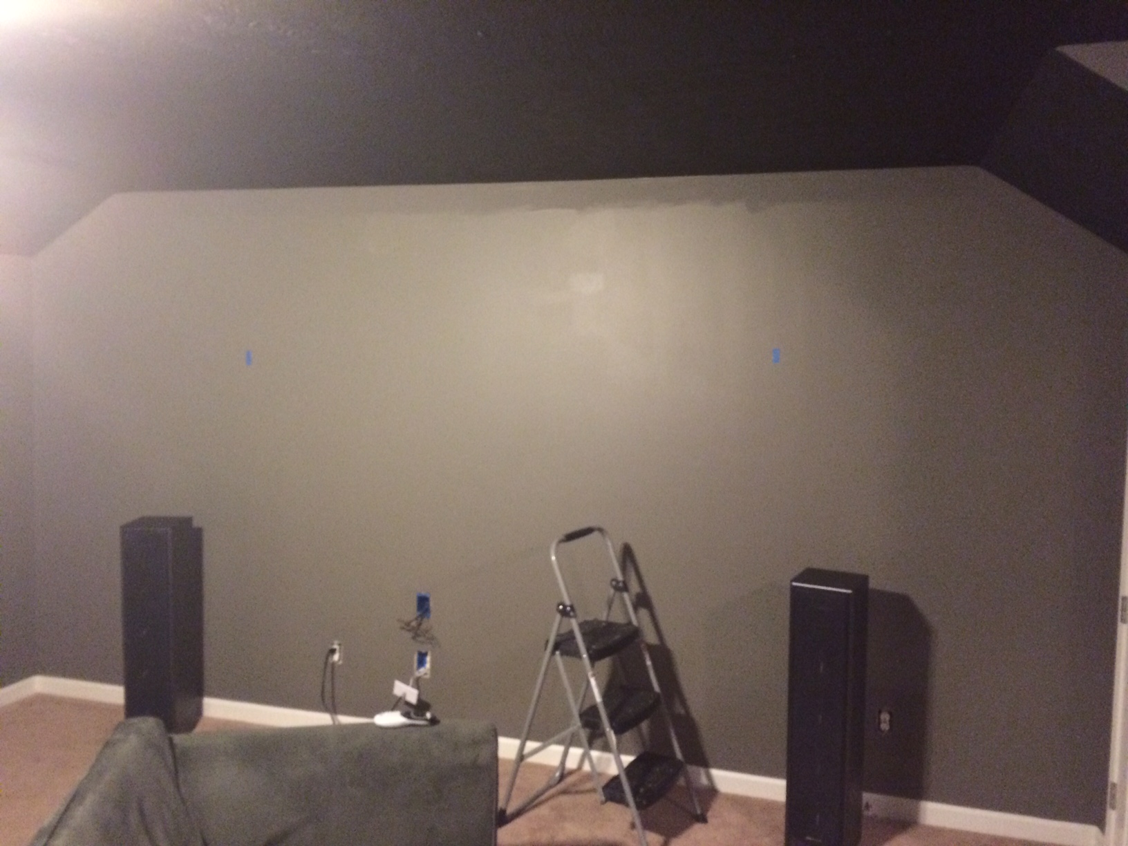

So here is my front wall, and tower placement is close. You're saying my sub would work well in that far left corner OUTSIDE of the left tower?
WaynePflughaupt
WaynePflughaupt
Yes. Keep in mind that it will probably require outboard parametric equalization, if your receiver can’t do that.
