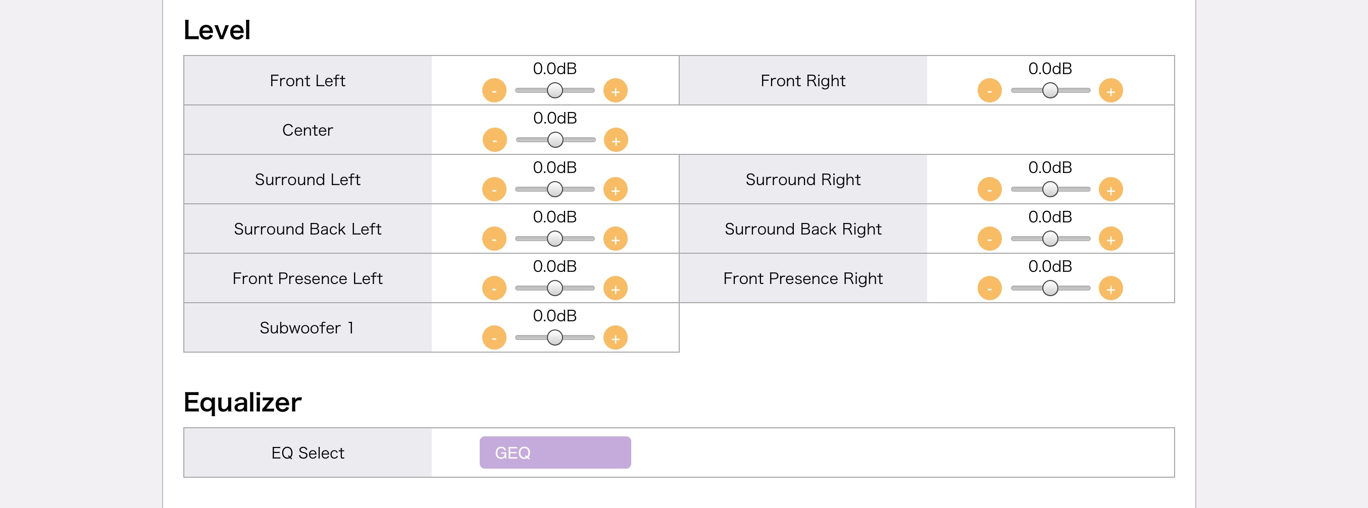

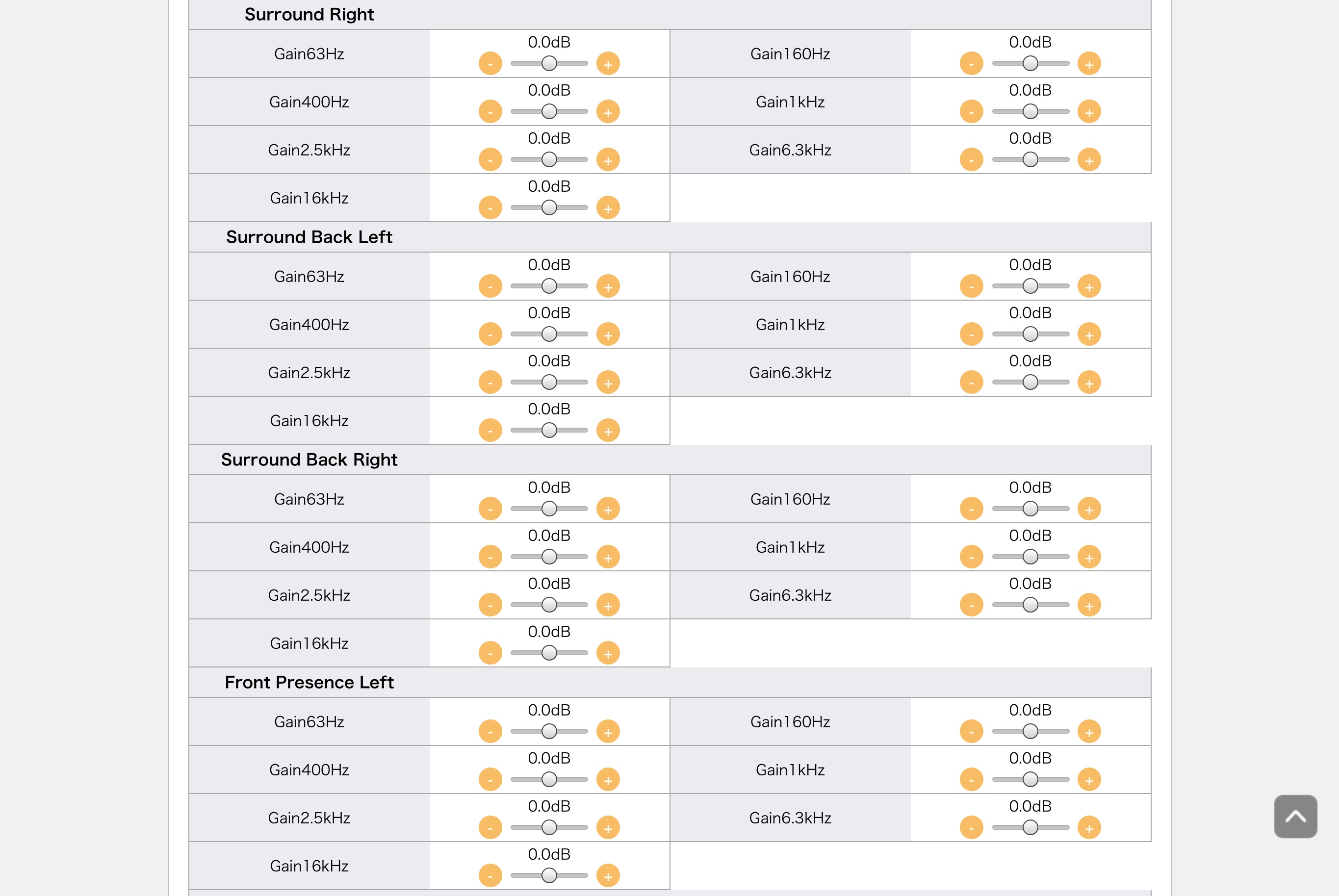

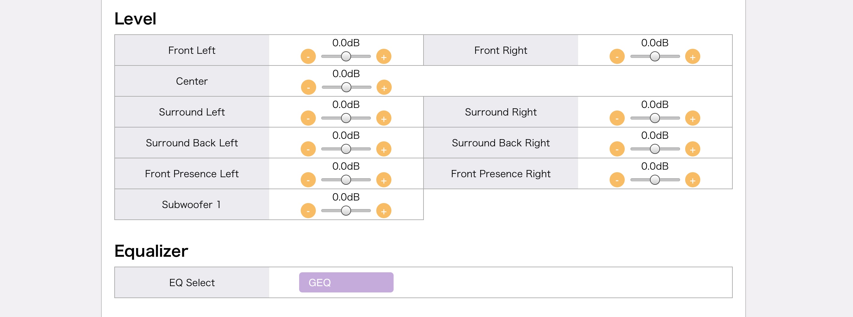

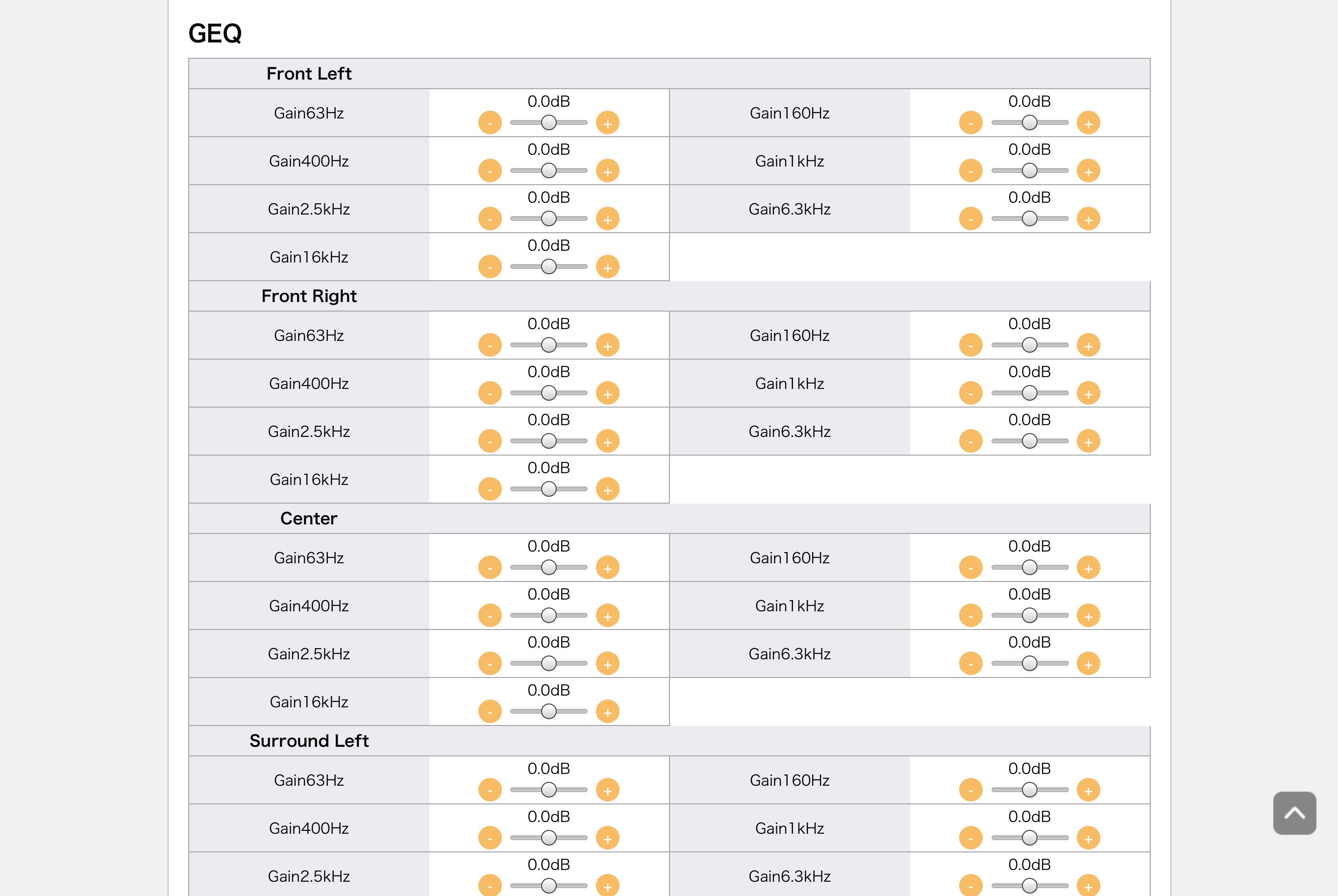

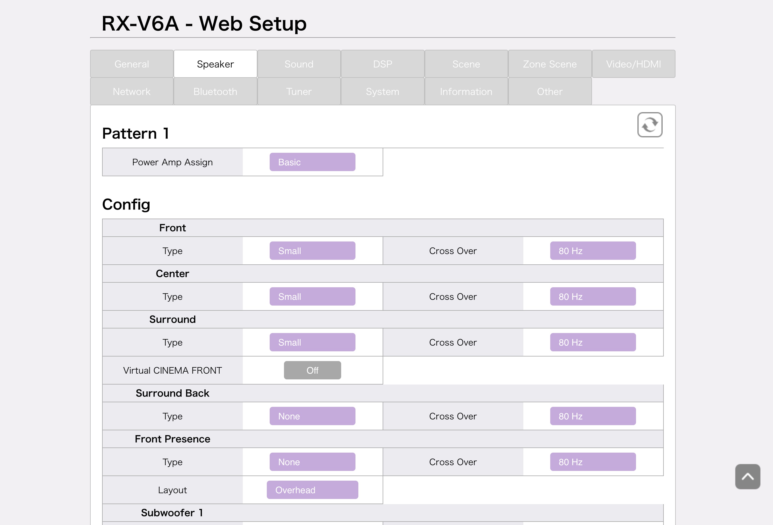

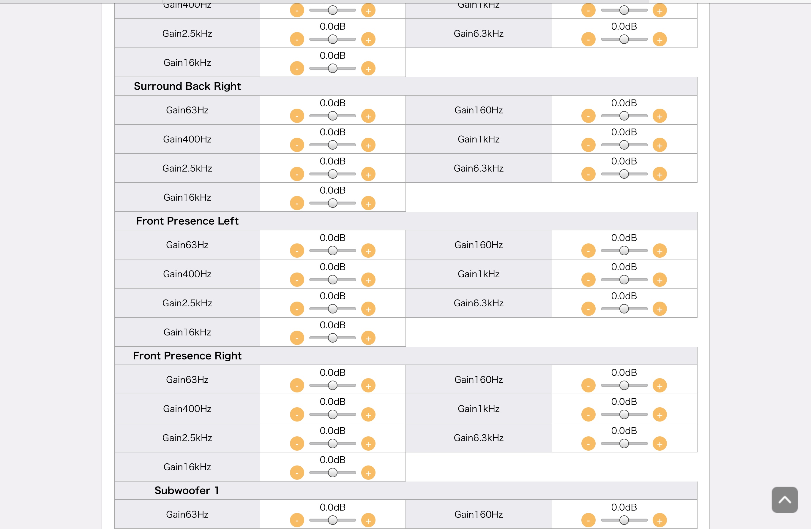

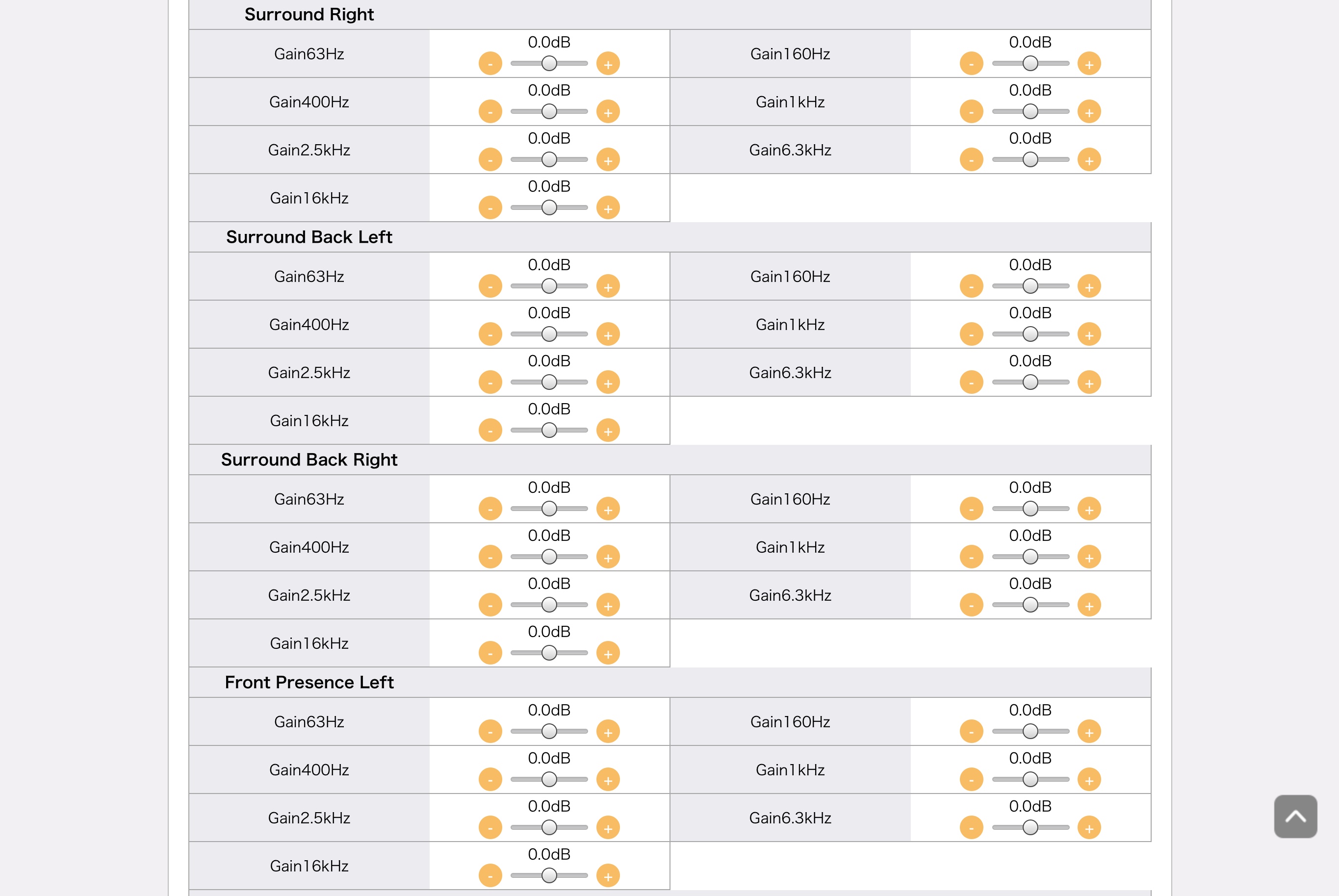

I tried typing in my TSR-700's IP address and was able to get to a menu. After trying all the available menus I could not find a menu where I could adjust the db levels on the sub and speakers or the EQ.
Have you been able to do this with the same receiver?
Trebdp83
No, that menu will not help you. You need to type in your address like so, xxx.xxx.xx.xxx/setup. Without typing in /setup after the numbers, you will not get the web setup. If typed in correctly, you should see the TSR-700 - Web Setup. Here are pics of mine.
L
Los Pollos 2000
View attachment 44331View attachment 44332View attachment 44333View attachment 44336View attachment 44337
Thank you for your patience! I went home and forgot the "/setup" part.
Back to the drawing board tonight. I greatly appreciate everyone's help!
