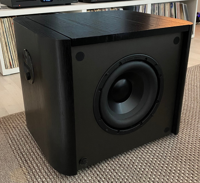

Plate amps for subwoofers are bears, I am having tons of issues and thinking to just rip out the amps and go with external amplification. The Audio Physic Rhea II is excellent subwoofers but there is too much of known issues with the plate amps and Chinese built amplifiers willingly breaking. I am having 4 subs so, external amps for all of them :cool:
So here we go my friends :cool:
Has anyone here done anything with Labgruppen? experiences?
I'm thinking specifically of PDX3000 or PD3000
The difference between these two is that the PDX3000 has various DSP controls, while the PD3000 does not
These seem to be pretty hefty, more than enough power for my needs; seem to be well built solid pro-class d amplifiers, and Labgruppen semmingly have rock-solid reputation for being unbreakable ....
So: Use Case is external amplifiers for subwoofers = knocking out troubled plate amplifiers and running external amplification ;)
Input anyonw?

That looks like a sealed sub. If that is the case it will need EQ below the native F3 and a high pass at driver xmax to prevent driver damage.
So you will need an accurate model of that driver in that box.
If it is a ported sub then it is a straightforward proposition, but not if it is a sealed sub. So if you get an external amp, then you need an amp and equalizer.
There are plate amps with equalizers for DIY sealed subs, which might be a solution. You might be further ahead buying new subs though. May be one Arendal could replace all your subs and you would be further ahead. They are in your part of the world.

So you are saying this is a passive radiator design, with a passive radiator in place of the port. So this acts basically like a ported enclosure, but the roll off below F3 is 36 db per octave versus 24 db per octave for a port. A passive radiator is used when a port will not fit in the box.
So this sub will not have Eq, though it may be high passed above F3. Unfortunately there is no useful information on these units on the NET. No meaningful specs were ever published, which is a red flag to me. I highly doubt the Arendal subs would be step down. If those subs are as good as you say, they would have posted bragging rights so everyone could see and recommend them. I certainly could not give them any seal of approval, or give them a recommendation. The absence of meaningful specifications would lead me the steer people away from them.
But yes, you could use an external amp, and if you noted excessive excursion of the driver or passive radiator, you would need to high pass, but I can't tell you at what frequency.
