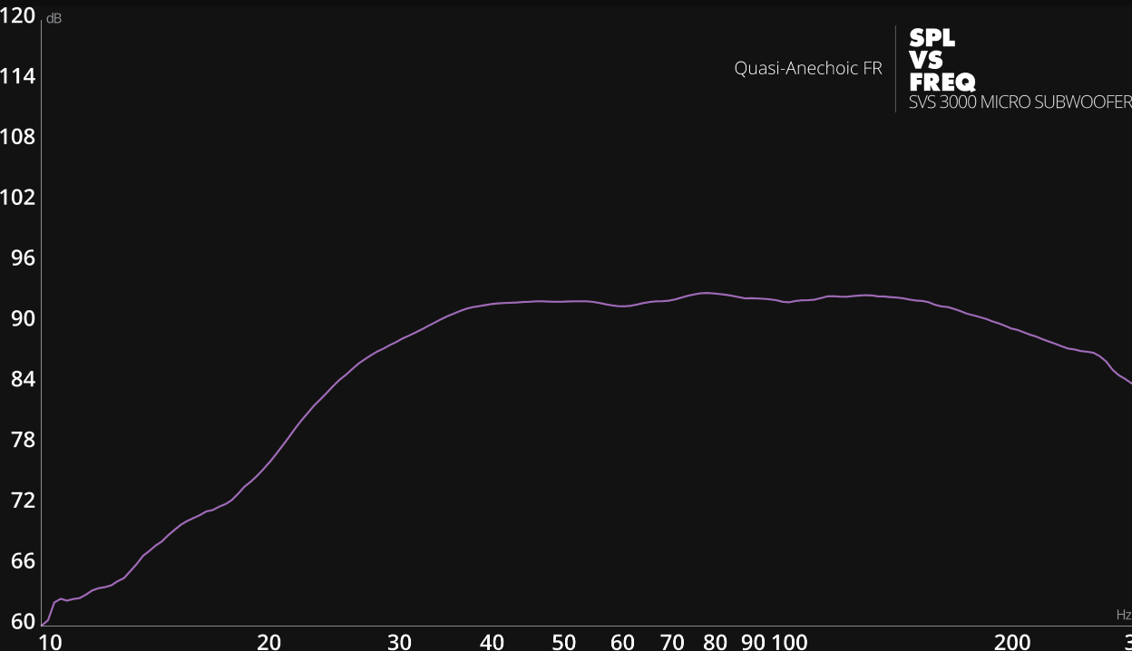

Let's take a look at SVS' fr chart for the Micro.
That looks to me like a -3dB of about 30 hz or so, which is not sub territory. By the time we hit 20 hz it's down about -20 dB. If you managed to get it flat to 20 hz I'm curious how you did it. Can you post some of your REW sweeps?
Woofer , not sub, according to the fr.... But i bet it sounds decent above 40.. That's pretty flat..
