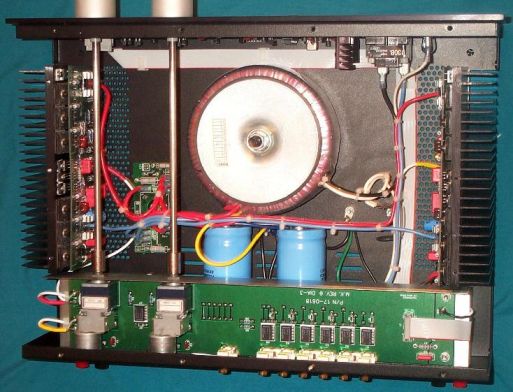

His amp would be very easily modified to provide pre outs and amp ins.
This is the circuit.
You could easily interrupt the circuit between the balance control and the amps. The case would have to be emptied for precise drilling in the shop, then re instal with the four RCA sockets.
The case is nice and open and would be an avenue for him. That is what I would do, but I have the facilities.
Actually on reflection, I think that unit is not worth the trouble. It has a passive preamp. Audiophools think this is an improvement, because it eliminates some active devices. They are dead wrong as they introduce worse problems. This is shown by JA in that in that unit the input impedance varied with volume setting. Now the negative feedback feeds back to the first stage of the power amp where the passive preamp connects. JA did have this amp go into supersonic oscillation under test. So I believe the sub connection is sending his amp into supersonic oscillation via the the negative feedback, which goes from out put to input.
If that amp is to be modified, the a IC buffer amp should be designed to go between the passive preamp and the power amp. That would add complexity, but not be very difficult. In addition to solving the OP's problem, I believe it would substantially improve the unit.
However it might be better to sell it along to an audiophool and buy a Creek integrated. These have preouts and amp ins and are designed properly, which this Acurus is not. That is assuming the OP wants to stay with an integrated amp.
