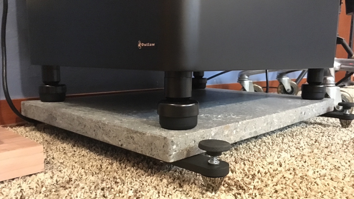

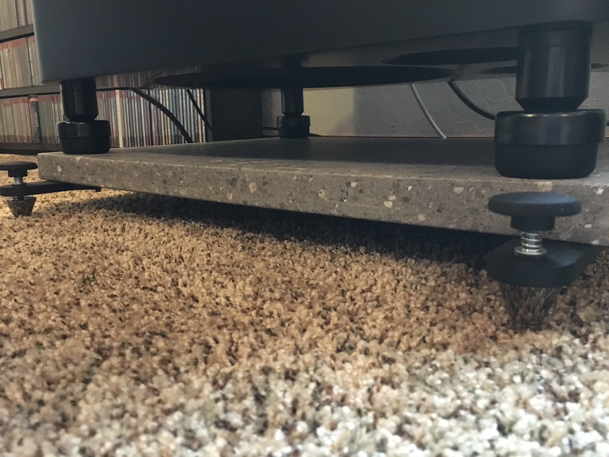

My own experience:
My goal was to minimize pass through vibrations due to my floor being super spongy. My own estimation is that by combining the isolation feet with the platform on spikes, I reduced the structural vibrations by around 85% total. Neither solution worked well enough on its own. Mind, the outlaws are powerful subs, especially in my little room. Distortion does not come into play with these, unlike the way my little 10” HTIB behaves.

My own experience:
Regardless, just some ideas to help you through the trouble with your neighbor.
This might be what I try. Did you make the spiked platform or buy it?
ryanosaur
ryanosaur
I bought outriggers from soundocity, had a local concrete fabricator sell me scrapped countertops cut to the size I wanted, and made them myself. If cost isn’t an issue, that’s a good path and will look nice. If you can find a quarry or landscaper that deals in granite, granite slabs cut to size are best.
That said, the wood cutting board is an excellent way to do it for at least half the cost. Webstaurant for the cutting boards, parts express for adjustable spikes from Dayton Audio... boom. Probably less than $50 per.
