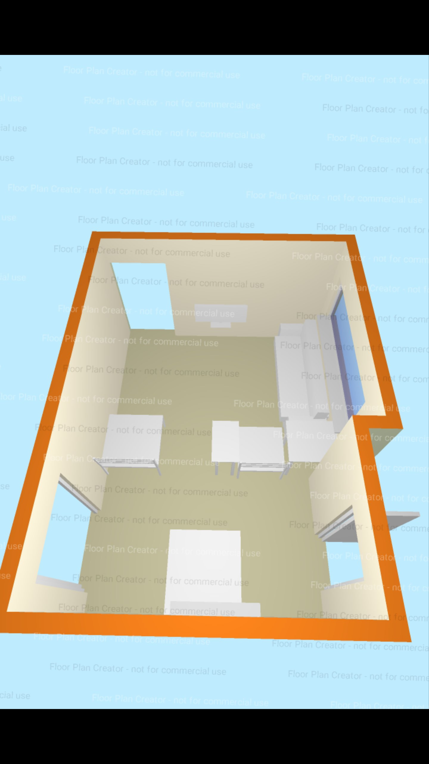

Here is my layout, the doorway locations are approximate but the dimensions are correct, speakers are beside my tv, unfortunately only 6" from the wall.

Would putting the sub under here be unwise for any reason?
It has 14.5in clearance and the sub is 13.5" tall so it would fit, but being essentially a corner and surrounded by the couch, chair as shown... Idk
That space should work, although it is not the greatest for ventilation. Still should be good enough for a well-made sub. Regarding height, make sure that those dimensions figure in the feet of the sub!
Great point, I will check into that.
And the couch and chair are old school, they actually have 3-4inch legs so the sub should have ventilation. My fiance will put up with quite a bit of my nonsense, so if I can find a clever way to rearrange things that is practical I can get away with it.

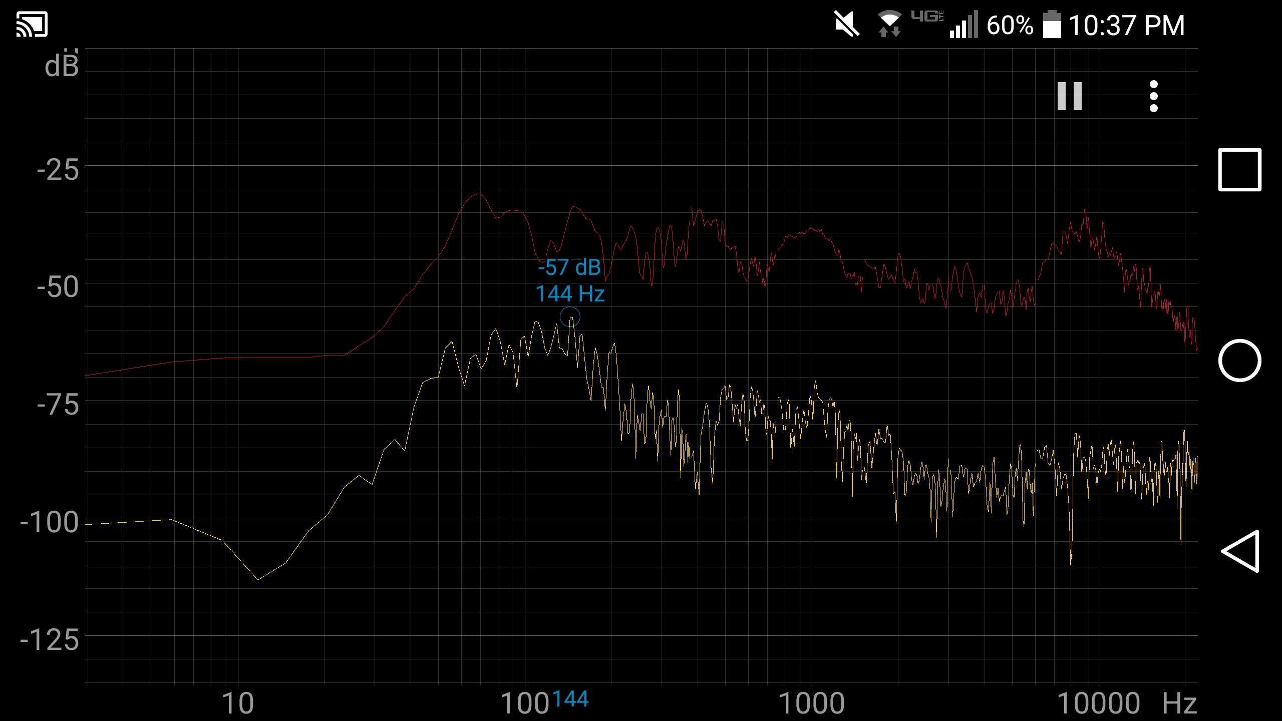

SPL at what frequencies? What about particular room modes? Try this article to start https://www.soundandvision.com/content/schroeder-frequency-show-and-tell-part-1
Interesting article though I am not sure how it translates to this discussion (forgive my ignorance). Are you suggesting that I find a subwoofer who has a dip in response that correlates to my room modes for a more even overall response?
I am sure it will annoy me having the mode spikes, perhaps I will have to look into the minidsp mentioned in the article. Unfortunately my Denon only has the bare bones Audyssey, which I have come to prefer having it off anyway, but I know their higher end models have some sort of multi-sub correction technology.
What would you say is the best way forward?

BTW I do have Spectroid, an app on my phone (which has 3 mics), I could probably play pink noise and record the results on the app, though I am not really sure what I would do with the results...
No, just meant the particular room and setup rules the sub's performance, hard to go to a store and make a meaningful determination; your room is the best place to demo if you can swing it (or buy from an internet direct seller that offers satisfaction guarantee including return shipping, one thing that SVS is good for particularly, might even consider the RSL Speedwoofer 10s). Sonic memory isn't something I'd rely on in any case. Barebone version of Audyssey is 2EQ...then MultEQ, then MultEQ XT and on top MultEQ XT32 (which with the SubEQ feature can handle separate level/delay settings for two subs). I've had good results with XT and XT32, haven't used the others but any MultEQ version would be better for subs than 2EQ (which IIRC has no filters for the sub).
